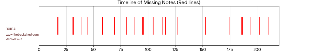

Comparison between the transmitted data stream and the recording:
As soon as I switch the working directory from the flash drive (drive a:) to the SD card (b:), I no longer have any missing data!
Hence my question to the AI and my attempt to verify this explanation with you.
