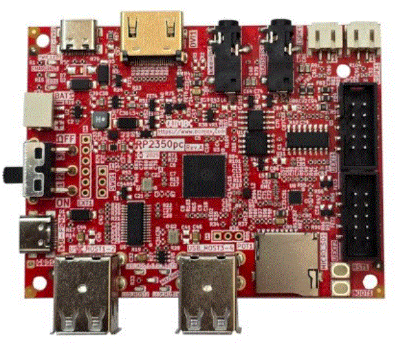

Posts: 3886
Posted: 01:07pm 23 Aug 2026
Olimex PR2350 board 24.95 EUR
"RP2350B all in one computer with 16MB Flash, 8MB PSRAM, DVI / HDMI display 4 USB hosts Stereo Audio and UEXT connector"
Is it otherwise compatible?
Posts: 12110
Posted: 01:20pm 23 Aug 2026
Better than some -but....
PSRAM on GP8
No RTC
No console
Audio wires I2S MCLK if needed then audion won't work
