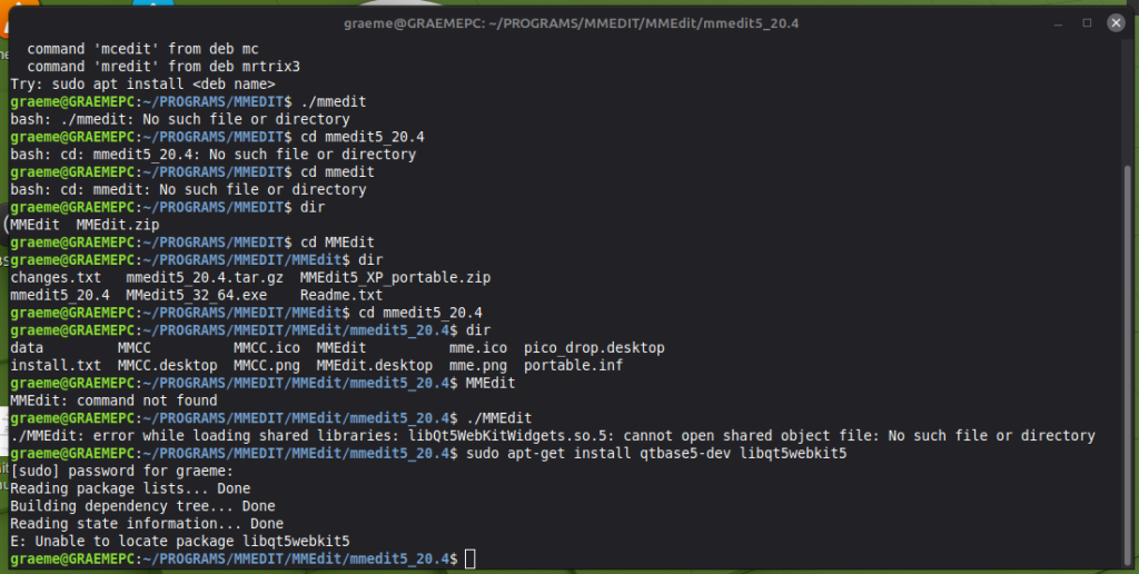

Just upgraded to LMDE7, and that all went smoothly enough, but now MMEdit won't run.
Trying to run it from the terminal, revealed that the libraries that MMEdit needs, were obviously removed during the upgrade.
I tried to add them back in the usual way, but LMDE7 reports that one of the packages no longer seems to exist.  Any ideas?
Is there a specific repository I should be including?
It's just the default LMDE7 ones at the moment.

Linux doesn't believe in being backwards compatible.

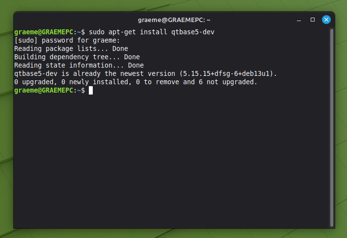

Try sudo apt-get install qtbase5-dev
(without the webkit)
And download the latest version of MMEdit.
In the latest version, I changed the way the help is displayed to avoid the need for the webkit library. It now uses the default web browser (hopefully).
I forgot to remove the webkit from the install instructions.

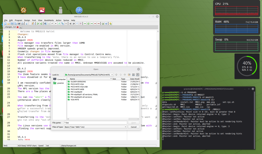

Downloaded MMEdit5, and this one when I try to run it, I get a blank window for about 1 second, then it closes.
Back to the terminal....
I CAN start it from the terminal, but NOT by just double-clicking the file itself.
Once open, everything seems to work, BUT if I close the terminal, MMEdit also closes.
I think I'm on the right track though, so it must just be some simple configuration thing at this point.

EDIT: Checked for the latest qtbase5-dev, and LMDE7 reported I already have the latest version installed.

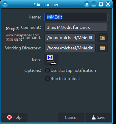

FYI, I could never get MMEdit to run in the past due to dependencies, however with the latest version, it appears to run perfectly on my system: Linux MX-25_2 Kernel 7.1.9-1 x64 Inifity, Liquorix-amd64 x86_64.
Ran first go from the Install directory, obviously like most things, you need a launcher with resolved paths to launch from the desktop or Menu, a really nice update.

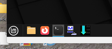

I used the icon file in the ZIP, so that the launcher icon on the desktop, has the official MMEdit icon for it, but when I open MMEdit, the icon on the panel stays as the default launcher icon.
Anyone know how to change that?
That's not an MMEdit specific issue, I have other launchers that have a selected icon graphic, but when they're open, they all show up on the panel with the default launcher icon, not the one selected for the desktop icon.
Not an issue really, but I would like to know how to change that if possible.
For example - GFXterm shows up on the panel with the green ">_" icon, and other panel icons are also whatever they are, so there must be a way to do this, but I have not found out how yet!

The Launcher in MX is below, navigate to the icon, select, and it always works, afraid I can't be of any help with why LM is having an issue.
Posts: 6231
Posted: 06:24am 27 Aug 2026
Hi Grogster,
The desktop file is typically placed in the folder /usr/local/applications in a linux system. You need root access to put it there. When the file is "understood" by the OS (syntax) it will show up in the menu, and can be placed on the desktop. Apparently the syntax is okay, becuase you can see MMEdit in the menu.
When the icon file is not found (path incorrect) the default icon will be shown (different per OS and per icon set). Similar, when the graphics format of the icon is not recognized (i.e. TIFF, where TIFF is not supported by this version of OS).
Since it worked on LMDE6, I am sure the graphics format is okay. So  the problem must be in the path towards the icon file.
Possible solution:
locate the icon files (the folder where MMEdit resides)
browse in the graphical file manager to the folder /usr/local/applications
make sure the files MMEdit.desktop is in this folder
right click, and select "open in terminal"
in the terminal type "sudo nano MMEdit.desktop"
change the path to the desktop icon file
type control-O (write) control-X(exit)
P.S. make sure there is no <space> (chr$(32)) in the path name. Very usable in windows, not in linux. If needed, rename the folder/file that contains a <space> before doing above edit.

Posts: 6632
Posted: 07:37am 27 Aug 2026
Not many users use the script I provided (dtopscuts.sh)
It assumes the archive was extracted to a folder under /home/user/
The info I based my install script on placed the .desktop file directly onto the desktop:
/home/jim/Desktop/MMEdit.desktop
One application I use places it's .desktop files:
/home/jim/.local/share/applications/MMEdit.desktop
Either seems to work and don't need any extra permissions.
I tried to find a reliable way to get MMEdit icons into the menus. On my Mint Mate, Using the menu editor, I can see the icons in edit mode but when I exit, the icons are not there, just some generic image.
I can edit the properties of the executables and give them the icon but that doesn't flow into the menu.
I have also failed to get icons on the taskbar.
