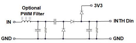

Work-arounds.
1) Reset the Timer when you start Play. Poll the timer to trigger the event at the right time.
Won't be exact but may be near enough.
2) Make a new audio file with the audio on one channel and control tones on the other.
Loop that channel back to an AIN pin (via a filter if PWM) to monitor the tones.

Posts: 3422
Posted: 11:32pm 26 Aug 2026
  Quote  Loop that channel back to an AIN pin (via a filter if PWM) to monitor the tones.
Could the signal on the looped back pin be used to trigger the patch switching?
A DIN could trigger an interrupt to do the switching.
The audio control tone, after filtering to remove the PWM carrier, could be AC coupled to a rectifier to trigger the DIN pin.
Edited 2026-08-27 09:57 by phil99
