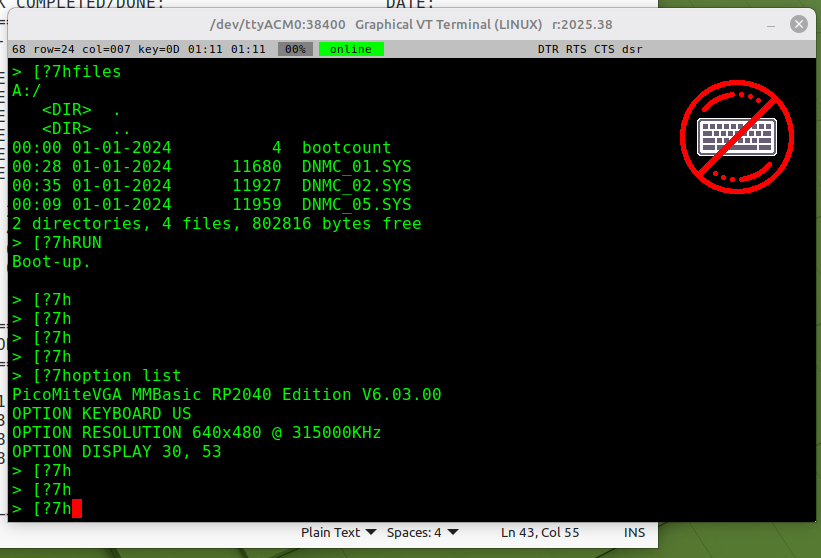

Forum Index : Microcontroller and PC projects : What's with the ''[?7h'' prompt?
Posts: 10085
Posted: 12:53am 27 Aug 2026
On all new FW versions of both the PM builds, this is the default command prompt.
What's up with this?
How do I disable it and just go back to the standard > prompt?
This is NOT visible on the VGA or HDMI output, but only on the console.
Is this something to do with advanced graphics control of the connected terminal?
I tried turning colourcode OFF, but it made no difference to the console prompt - it's still there....

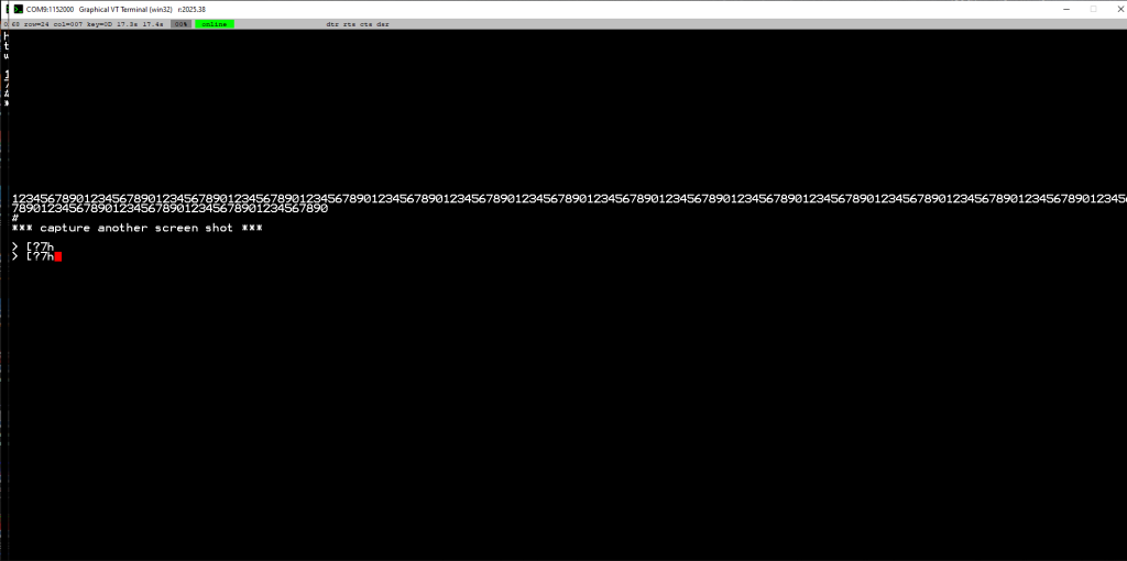

Posts: 10085
Posted: 11:30pm 28 Aug 2026
  robert.rozee said  however, i would expect you to also still see a ">" either before or after the "[?7h" text. can you please check this?
Before.  Here is an image:

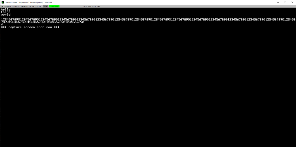

Posts: 2554
Posted: 03:22am 29 Aug 2026
hi Graeme,
   do you ever see "[?7l"appear? ie, with an "l" (lowercase L) instead of an "h".
i'm trying to figure out what Peter is trying to accomplish by adding in these escape sequences all over the place. try running the following test program (screen size set to 80x24), capturing screen shots where prompted and post the two captured images:
Const ESC=Chr$(27)
Print ESC "[2J" ESC "[1;1H";
Print "hello"
Print "there"
Print "world"
Print
For I= 1 To 200
Print Chr$(48+(I Mod 10));
Next I
Print :Print "#"
Print "*** capture screen shot now ***"
Do :Pause 10:Loop Until Inkey$<>""
Do :Pause 10:Loop While Inkey$<>""
For I=1 To 250
If I<=50 Then Print Else Print Chr$(48+(I Mod 10));
Next I
Print : Print "#"
Print "*** capture another screen shot ***"
Print
End
if you can, perhaps then try running using TeraTerm as the terminal emulator.
if Peter is just sending ESC "[?7h" sequences (AutoWrap ON), then i can safely discard them as GFXterm is already hardwired into that mode. but if he is sending AutoWrap OFF sequences sometimes, that makes life much more complicated for me.
rob   :-)
Edited 2026-08-29 15:33 by robert.rozee

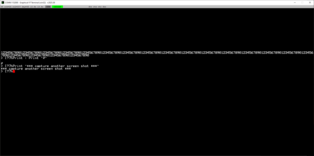

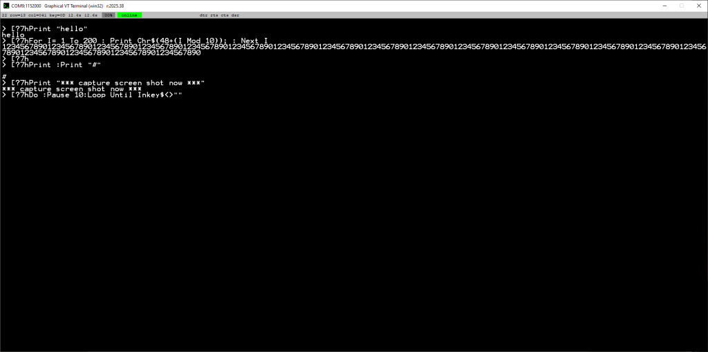

Posts: 3422
Posted: 03:57am 29 Aug 2026
Entered your program segments at the GFXterm command line (putting loops in one line).
Only "[?7h" sequences appear. No "[?7l" appear.
On Win10
In TeraTerm output is the same but without "[?7h" sequences.
Edit
Loading the whole program changes things.
This image was pasted over the previous one and was displaced a little so ignore the column of characters on the left.
Edited 2026-08-29 15:26 by phil99
