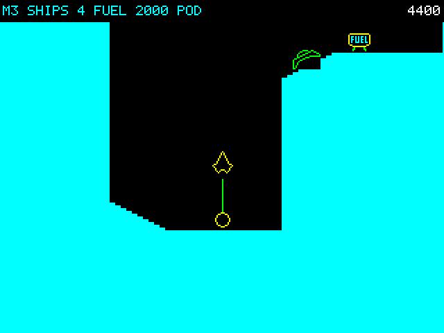

This is sort of like moon lander on steroids

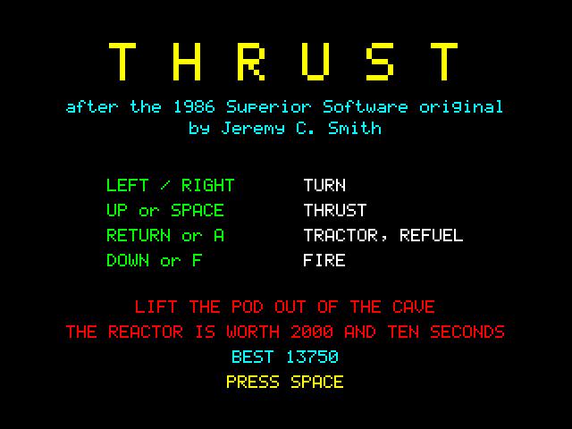

# Thrust for the PicoMite — player's guide
A port of Jeremy C. Smith's *Thrust* (Superior Software, 1986) for the BBC
Micro. The flight model, the levels, the artwork and the sound are the
original's own numbers, taken out of the published disassembly, so it should
fly exactly as it did in 1986. **This is a test build and we would like to
know where it does not.**
## What you need
- A PicoMite running **MODE 2** — 320 × 240, 16 colours. Any VGA or HDMI
 build, or a 320 × 240 LCD panel that supports `FRAMEBUFFER`.
- Firmware **V6.03.02b6 or later**. The sound is the BBC's own, played
 through `PLAY BBC SOUND`, which arrived in that version.
- A keyboard. Several keys need to be *held*, so a joystick will not do.
## Loading it
`Bas/thrust.bas` in the PicoMite repository. Copy it to the board and `RUN`,
or `SAVE` it and `RUN` from flash. It is about 76 KB of BASIC, so give it a
moment to load.
## Controls
| **← →** or **Z X** | turn |
| **↑** or **SPACE** | thrust |
| **RETURN** or **A** | tractor field — also refuels; blocks the gun |
| **↓** or **F** | fire |
| **ESC** | back to the title screen |
## The first thing to do, because it is not obvious
**You start with an empty tank.** That is the original's design, not a fault:
the ship is put down directly above the first fuel cell. So —
1. Press SPACE at the title screen. You will fall.
2. **Hold RETURN** as you drop. A line snaps to the fuel cell and the fuel
  counter climbs fast.
3. Now thrust, and fly.
Each fuel cell is a fixed ration. Sit on the beam for about a second and the
cell is used up, worth 30 points and roughly twenty seconds of thrust.
## What you are trying to do
Lift the **Klystron pod** off its stand and carry it up out of the cave.
- Fly down to the pod and **hold RETURN** until the beam appears, then **pull
 away**. The pod lifts off as the line goes taut. It is not a grab — it is a
 tow.
- The pod hangs on a tether and swings. Thrust across the tether sets it
 swinging and thrust along it does not, and a swing does not stop on its own
 — you have to fly it out. Everything you thrust with the pod aboard is at
 half power.
- Fly up out of the top of the cave and the mission is complete.
- **Leaving without the pod costs you a ship.** There is a `NO POD — TURN
 BACK` warning in the panel before you cross the line.
The **reactor** is worth 2000 points. Shoot it fifty times and the planet goes
with it — and you have ten seconds to get clear, counted down in the panel. It
is the difference between a 2000-point mission and a 4000-point one.
Limpet guns are bolted into the rock and shoot at you. They are worth 75 each,
fuel cells 15 if you shoot them instead of drinking them.
Anything touching the rock destroys you — the ship, and the pod you are
towing. There is no landing in Thrust.
