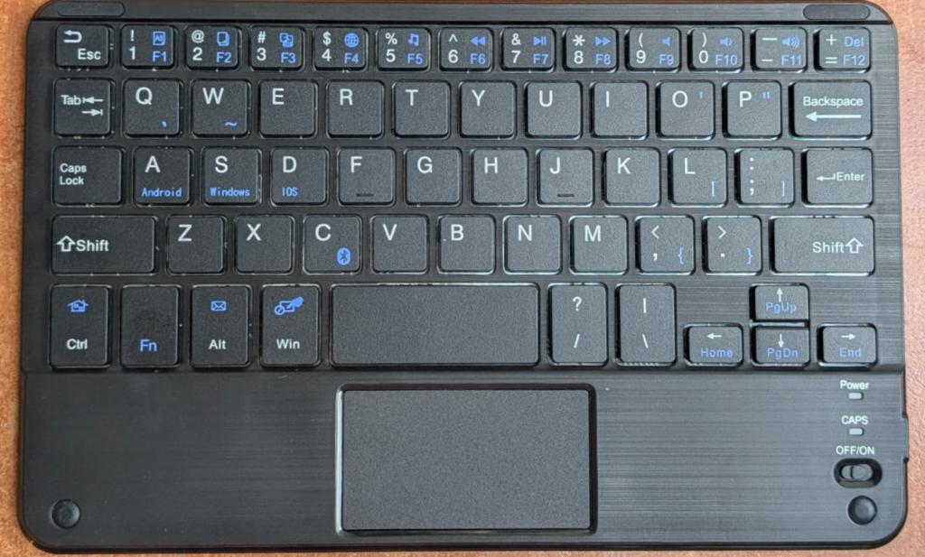

On the PicoMiteRP2350BTH and the PicoMiteHDMIBTH a Bluetooth keyboard no longer has to be a BLE one. An older Bluetooth Classic keyboard, and the touchpad or mouse built into one, now works alongside a BLE keyboard and a Bluetooth speaker, all three connected at once.
• Finding it. Put the keyboard in pairing mode and run BLUETOOTH SCAN. It is listed as a Keyboard, as speakers are listed as Audio.
• Pairing it. BLUETOOTH CONNECT "name" (the name SCAN showed, or the address) pairs it. If the keyboard asks for a code, the console shows Bluetooth keyboard pairing: type NNNNNN on the keyboard being paired, then Enter, as it does for a BLE keyboard. After that the keyboard reconnects by itself whenever it wakes up or is switched on, also after the board restarts.
• Keys and touchpad. The keys go through OPTION KEYBOARD like a USB or BLE keyboard's: the layouts, the lock keys, auto-repeat and KEYDOWN() all work. A touchpad or mouse is DEVICE(MOUSE 2, ...), the same as a BLE mouse.
• Tablet keyboards. Many low-cost keyboards sold for tablets have an operating-system mode, chosen with an Fn key combination or a switch (see the keyboard's instructions). Use its Windows or PC mode: in its iOS mode such a keyboard sends Cmd+arrow for Home and End and iPad shortcuts instead of F1 to F12, and its touchpad changes too.
• BLUETOOTH STATUS has a Classic keyboard: line: the keyboard's address, whether it is connected, and which of its reports carry the keys, the pointer and the media keys. MM.INFO(BLUETOOTH KEYBOARD) gives its address when no BLE keyboard is connected, and BLUETOOTH FORGET forgets it.

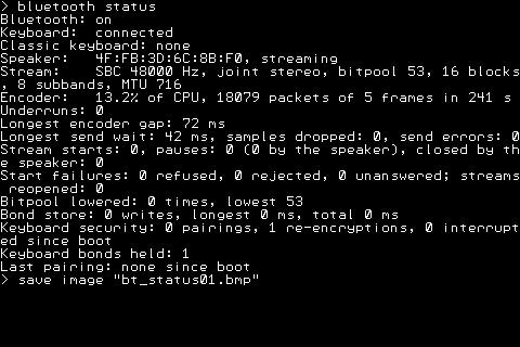

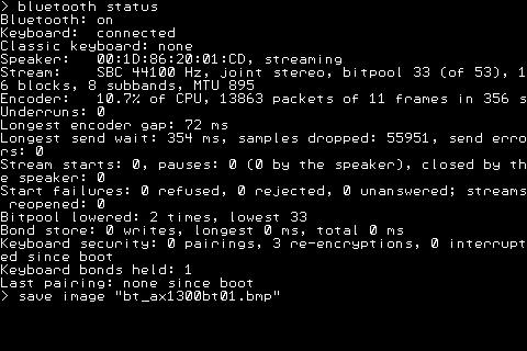

New in beta 8: Bluetooth speakers that work better
A tester tried beta 7's Bluetooth audio with four devices: a generic receiver, a Milwaukee M12 site radio, a generic transmitter/receiver and a car stereo. Only the receiver worked properly. These changes, on the PicoMiteRP2350BTH and the PicoMiteHDMIBTH, are for the other three and for speakers like them.
• Speakers that pair, then refuse the sound (BLUETOOTH CONNECT stops with Bluetooth error 0x66). Some devices agree a shorter encryption key than the board insisted on. It now accepts any length the Bluetooth specification allows, 7 to 16 bytes. The tester's transmitter/receiver, which gave these errors in beta 7, now works.
• Speakers that connect but stay silent. The board could put more sound in one packet than the packet's header can count, and it offered only stereo, which a speaker that plays only mono cannot take. Packets now hold at most 15 frames, and mono is offered too (stereo is still chosen whenever the speaker can play it).
• A speaker that plays only if the sound starts as it connects. The M12 played if PLAY was already running when it connected, but stayed silent if it connected first. When a speaker closes the board's audio stream, or does not start it when asked, the board now connects to it again when PLAY next needs it. The sound waits for up to 8 seconds meanwhile, so it starts late (by 1.5 to 5.5 seconds in our tests) rather than being lost. If that does not help, the next try waits 20 seconds, then longer. We have not had an M12 to try this with. OPTION AUDIO BLUETOOTH 0, which keeps the stream running from the moment a speaker connects, is another thing to try with such a speaker.
• Short gaps every few seconds (the car stereo). The sound always went at the highest quality the speaker accepted, about 330 kbit/s. Over a link that could not carry that, the board fell behind until it had to drop a quarter of a second of sound. It now lowers the quality (the SBC bitpool) a step at a time while the link falls behind, and raises it again after ten seconds without trouble.
• BLUETOOTH STATUS tells you much more about the speaker: its packet size (MTU) and the frames in each packet, the quality in use (bitpool 41 (of 53)) and how often it was lowered, packets the radio refused, how often the stream started, paused (and how many of the pauses the speaker made), was closed by the speaker, could not be started, and was reopened. If a speaker still misbehaves, a BLUETOOTH STATUS listing taken while it plays, or straight after a dropout, shows which of these it is. Please send us one.

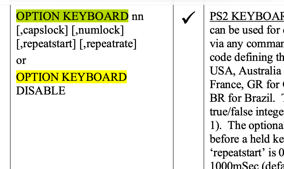

Peter,
I have a similar keyboard, but it's connected via USB (Pico 3 computer).
Is there a way to set it so that NumLock is NOT enabled when the computer is turned on?
Cheers Martin
'no comment
Posts: 12306
Posted: 06:08pm 09 Oct 2026
OPTION KEYBOARD xx,0,0 should do the trick - missing from the manual for some reason

well that is it.
I guessed to be the only person with "num lock" on at startup...
what is the meaning of the further parameters?
hhtg1968
Joined: 25/05/2023
Posts: 323
Posted: 06:46am 10 Oct 2026
I found it in the manual...

AXIS AX1300BT Car radio - AUDIO INTERRUPTED - Clicks and stutter in audio at random times.

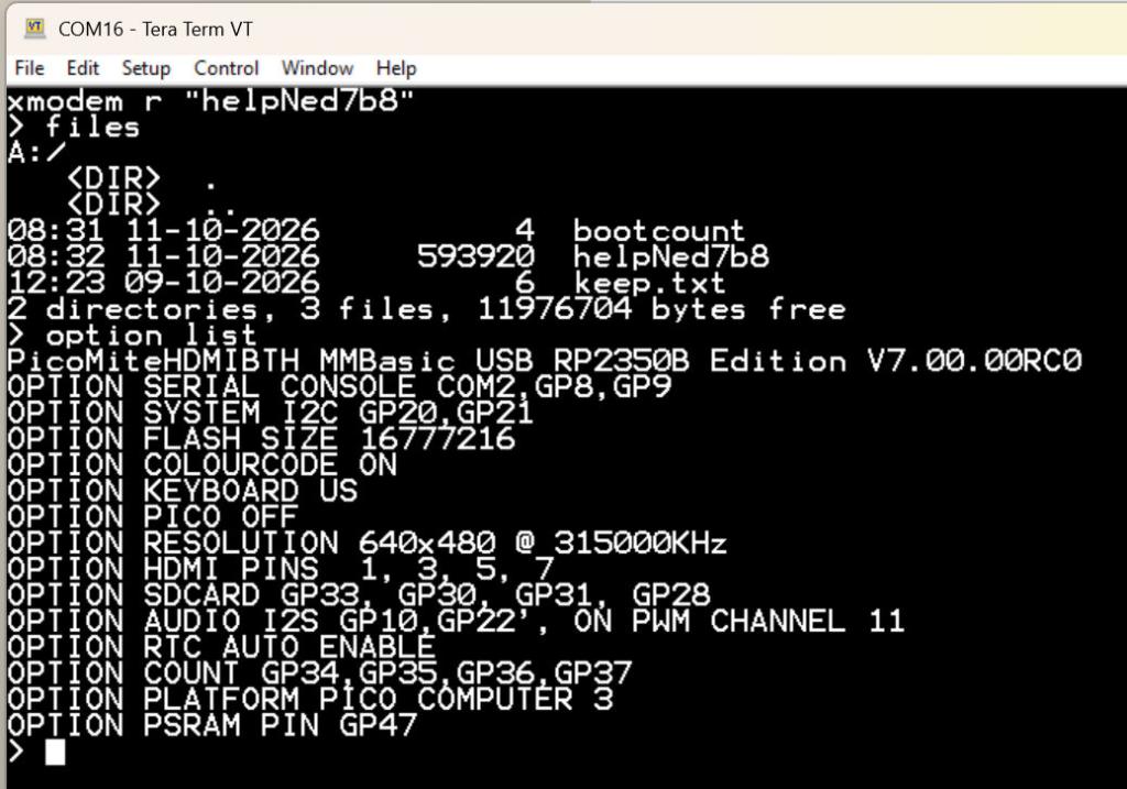

Is it correct that with version PicoMite MMBasic RP2350A V7.0.00b5, the help.txt files can be successfully loaded via USB using Xmodem, but with PicoMiteHDMI MMBasic USB RP2350A Edition V7.00.00b5 and higher, they cannot be loaded via an external RX/TX connection?
Jan.
Posts: 12306
Posted: 06:35pm 10 Oct 2026
There are loaded over the console like any other build. All USB host builds have the console on GP8/GP9 and need an external usb/uart unless using one of the boards with one already there like the Pico Computer 3

I have tried to catch a Blutooth Status report at the exact moment the AX1801BT stereo glitched but so far no amount of tries shows a significantly different outcome to those posted previously.
