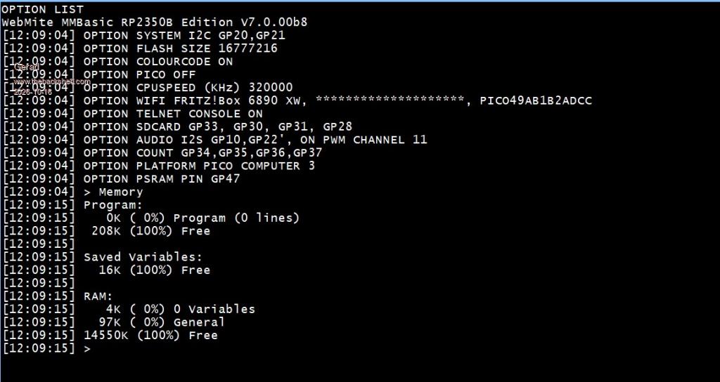

What do you think of the 16MB fix? The fix was created by “Claude”
PicoMite / WebMite 7.00.00RC2 - fixes for the RP2350 PSRAM builds

The change is trivial and wastes 8K of precious real memory for every build that doesn't have a 16Mb PSRAM chip which is precisely why I won't do it. To do it properly the psram map has itself to be in psram which changes the 6MB and again affects everyone

That may be true for many “Webmite” users. But anyone who also uses the RP2350B with C++ knows exactly how valuable 16 MB is. And I'm sure it won't be long before 8 MB of PSRAM isn't enough RAM for Picomite/Webmite either.
