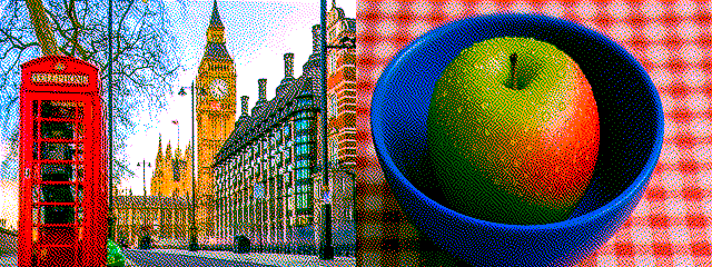

  RicM said  Have any games been ported over to the rp2350B but only 16 colours at one time.
The 16 colors result from the fact that only 4 bits per pixel are used. Due to the hardwired configuration of the PICOMITE VGA models, the RGB 121 color scheme has become the standard (i.e., 1 bit for red, 2 bits for green, and 1 bit for blue). With a little imagination and skill, this allows you to create some quite appealing images.
Game characters (SPRITES&TILES) can also be drawn quite impressively using this method; see Volhouts
PETSCII ROBOTS.
When PICO2 came out, the HDMI output was added, the system was expanded so that the 16 colors can now be assigned to user-defined colors: Color MAP The limit remains at 16 colors (4-bit) per image, but you can now choose them freely.
