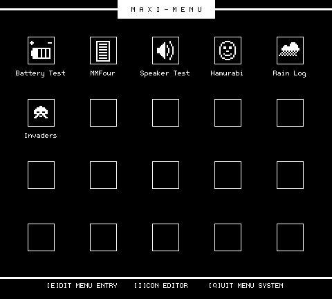

I'm about to release my menu program, "Maxi-Menu".
Just a few small things to tidy up and it will be available for download.

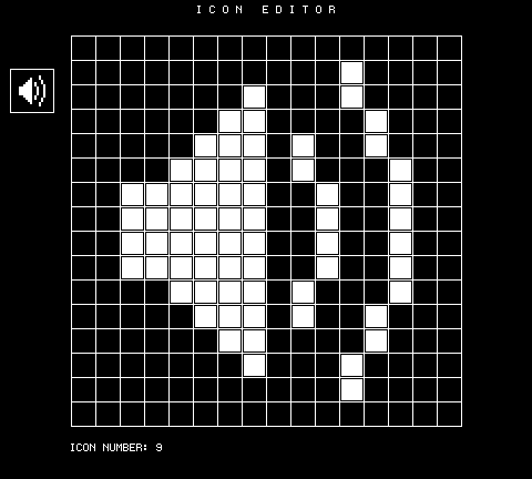

Here are two screenshots. The first is the main menu page and the other the built-in icon editor.

Well, here it is!
This is a program launcher, styled in a somewhat Ipod fashion with icons that the user selects to launch the desired application.
The program MENU.BAS along with it's icon data file ICON.DAT, is to be copied to the root of the SD card.
Another program MBOOT.BAS is generated to facilitate running of another user selected program, from within the Menu Program. (INPUT filename$:RUN filename$ doesn't work so this was the workaround)
If MENU.BAS is renamed to AUTORUN.BAS, the program will boot on powerup.
The first thing the program does is look for the MENU.DAT file which contains the menu definitions. On a clean install such as this, it will see that it is missing and create a blank one. From here the user enters menu entries, providing a Menu Entry Label, Program Filename, Directory (only 1 level), and an Icon (selectable from 32, I've predefined 17).
Keyboard instructions are included in the program listed as REM lines so check these out first.
Let me know what you think, suggest improvements and highlight bugs.

Works a treat Nick, well done.
Invaders?
Nick
Joined: 09/06/2011
Posts: 512
Posted: 10:35pm 24 Jun 2011
Invaders...in preparation for Bob's Space Invaders game he's writing. :)
They're only mockups just to use as examples. The program doesn't acually check what programs you have on your SD. The user can make whatever definition he wants in the menu, it will just go to the BASIC prompt if you try an execute and entry that doesn't exist. :)
If we had programmable characters, invaders could be defined and that would make it a lot easier to program.

You need to choose a box then select EDIT MENU ENTRY where it will ask you for...
1) A label (12 characters) to label the box.
2) A filename of the program you wish to define here.
3) A sub-directory (1 level down only) where the program resides (leave blank if root)
4) Then an icon number. Here you will see the icon palette displaying all currently defined icons. You can add/change an icon in the ICON EDITOR and it will update the ICON.DAT file.
The program MBOOT.BAS is always created because MMBASIC (as do most BASICS) don't allow a string in the RUN command.
