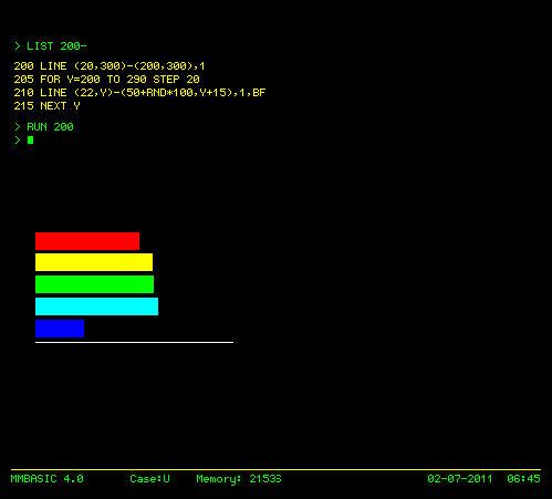

Last night, I had a dream that woke me up in the middle of the night. Confused, I sat up, checked the matress...nope, wasn't that kind of dream... and decided to get up and power the computer to recreate what I saw.
A colour maximite!!
With a new firmware that included a status readout at the bottom of the screen.
Fully programmable character set.
Flashing cursor and more.
I have tried to recreate that vision in my graphics editing program and this is what I have come up with.
Was it only a dream?

Regarding the color...
I added the colour based on my idea I mentioned in an earlier post. In this, I explained a possible simple way of creating colour where the single monochrome VGA line was fed into a digital switch which could be controlled on the I/O pins of the MM to channel the vga signal to different combinations of the RGB pins on the monitor.
This could be done with only a small addition to the video driver firmware by having a table of 432 bytes (the video vertical res) that is read during display creation in the blank period of a scanline. Each byte defining the colour (the colour switch setting) for the current scanline and sent to the switch.
Advantages of this simple colour modification...
- Simple add-on to the MM only requiring a small firmware upgrade
- Only uses an extra 432 bytes of extra memory on the MM
- Produces 8 colours (16 possible if an intensity signal is also used (RGBI)
- Simple plug in accessory, no other hardware changes to the MM
Limitation...
Only 1 colour plus black available per video scanline.
The image in my "dream" was drawn with this limitation in mind.

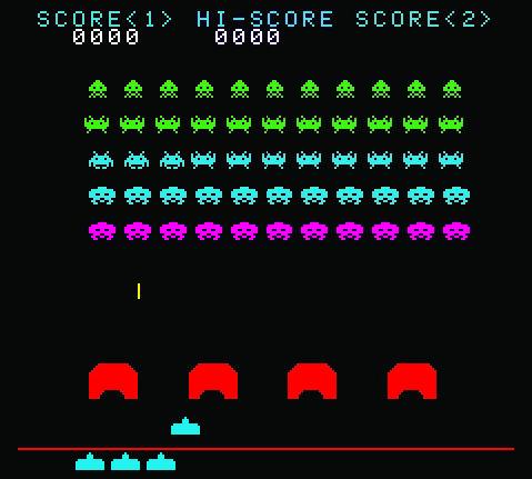

With the specifications and limitation I listed above, how would the MM cope with a video game?
I decided to put this to the test by creating a mock up screenshot of Space Invaders as could be created on the MM with the above specs. The only assumption I am making is that Programmable Characters are added to the firmware. An easy thing to add.
(Copy the current charcater set in "rom" to ram and change pointers to this copy. Either use POKE to change the character set or add a command for redefining the characters)

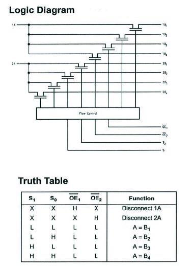

Can any of you hardware folk suggest a "switch chip" that I could use for this colour idea I mentioned? My hardware skills only go so far so this may be a good project for me to learn.
SPEC:
I want to be able to control a signal (VGA) coming in and via 3 of the output pins of the maximite (3 bit, 8 combinations), direct/channel it to 3 output pins (RGB) in 8 combinations.
- The chips should be fast enough to switch at least on each scanline of video.
- Low cost and easy to find (Jaycar, Altronics etc.)
Can anyone suggest?

Posted: 02:45am 03 Jul 2011
Could the 4066 IC do the job? Quad switch, but may need other input/output level conversion as I think it's a 5V IC.
(Be gentle, I'm only a beginner)
