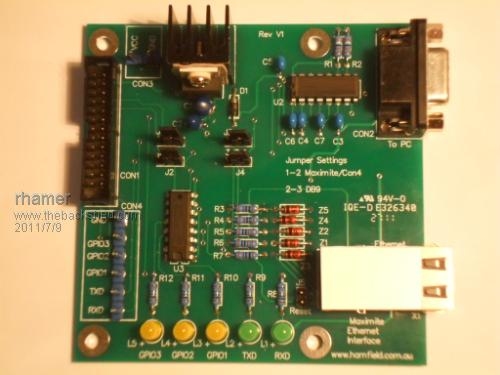

Folks,
Below is a picture of the first Maximite Ethernet interface.
However, there is one big short term gotcha. Until the Maximite supports serial comms it cant talk to the ethernet interface.
Having said that the unit does have a conventional serial port on it as well to allow development with a PC instead of the Maximmite, so the keen people could get started with that.
So how does it work?
Essentially it is a serial to IP converter (and back again) It does have some other tricks like an inbuilt Web server, SMTP for email alerts and 3 GPIO pins.
From the Maximites point of view it's just talking serial data in and out one of its ports, which gets converted to IP (TCP or UDP) by the interface. This in turn can be sent/received by a PC. If you run the virtual Comm Port software the data will appear on that virtual comm port. For the more adventurous, you can open a socket directly to the interface and communicate that way.
It is also possible to load custom web pages into the interface and interact that way, via a web browser.
I'm still testing it at this point, but so far it is looking good.

Looks good Rohan. It will be interesting to be able to access the Maximite via a web browser.

In fact it won't use up any.
All the Web server functions are generated on my board.
Just to be clear, this thing is no IIS, the web pages are basic HTML, with java to access the hardware. So don't think you are going to be doing anything too fancy with it.
The driving force was to provide 2 way communications with the Maximite to something else like a PC via Ethernet.

Nice idea, but with that Lantronix module running at $45 a pop it won't be cheap enough for hobbyists. I've used them, they're a good fast solution for prototyping, however production boards use something else.
