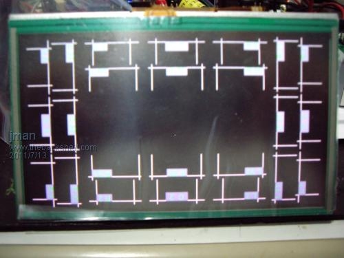

Posted: 09:48am 13 Jul 2011
Hi Gerard
Thanks for the info
It now works :)
I have attached a pic of the screen running I assume this
the intended pattern ?

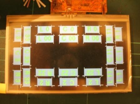

seco61
Joined: 15/06/2011
Posts: 205
Posted: 10:14am 13 Jul 2011
Hmm...
The screen is not what I would quite expect - have you loaded your fonts into the TftA?
regards
Gerard
Gerard (vk3cg/vk3grs)

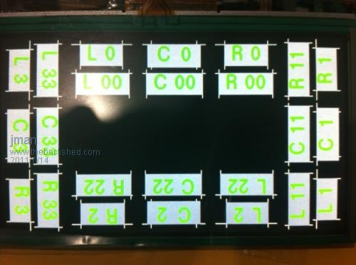

Joined: 12/06/2011
Posts: 711
Posted: 11:49am 14 Jul 2011
Hi Gerard
As you know it is now sorted now my pic looks like yours :)
Thanks again for the help
