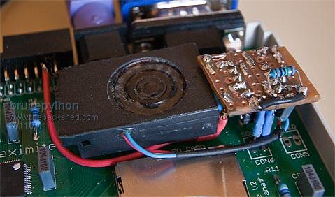

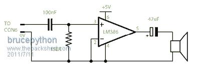

I hate trailing wires all over the bench so scrounged some bits from the junk box for on-board audio. It need two capacitors, a resistor, an LM386 and a scrap of circuit board. The speaker was chiselled out of an old laptop. Not rocket science. Works. Might be handy if you're desperate.

Nice Bruce, bit of a squeeze in there isn't it.

Yes, Glenn, my eyes certainly appreciated two pairs of specs while nailing it together.

In the circuit diagram the watermark has obscured the resistor value. It's 150R, more or less (or not at all) depending on how many neighbours you want to wake up.

Or read the color code. :-)

Bruce, a supplementary question, that I hope you can answer.
You no doubt know more about LM386s that I do, so to save me chasing it up, I am thinking of adding small audio circuit, to one of the boards I am designing.
The idea is to drive a white RCA female socket for standard audio out. This would be the standard input to a TV. This is of course, is to pipe audio and video into the usual yellow and white RCA connectors that most TVs have these days.
Would the gain and impedance you have set, match this setup?
If you or anyone else can give me the answer, it would be appreciated.

The LM386 is a very robust and forgiving little amp, You could just modify the resistive divider Geoff has on his board to both drive the LM386 as well as the audio out socket, or even run the two in parallel!

Thanks Rob, and resistor value for the application in mind would be adjusted to, uhmmm 149.25 ohms?
Only kidding, would you have a value in mind?

That infamous, colourful 150R resistor was no more than a quick'n'dirty fix to reduce the input level and avoid my beloved in the next room having broken sleep. A better way would have been to use the "official" gain control facility, which is a resistor and capacitor in series between pins 1 and 8. That would have required me to stuff more bits on the component side of the board and such contortions were already getting beyond my eyesight's capacity so I cheated. As Aargee says, it's a tough chip and can take evil treatment in its stride. Just as well because when I tested it I had it running (very unsuccessfully) with -5V across its power pins and it took a while to work out what was making the smell.
So, to answer your question, I suggest taking each input via a capacitor from the existing audio connector and adjust the gains of each amp using the components across pins 1 and 8. The data sheet is available from National Semiconductor's website (http://www.national.com/ds/LM/LM386.pdf) and there are some examples of various gain configurations on page 5.
