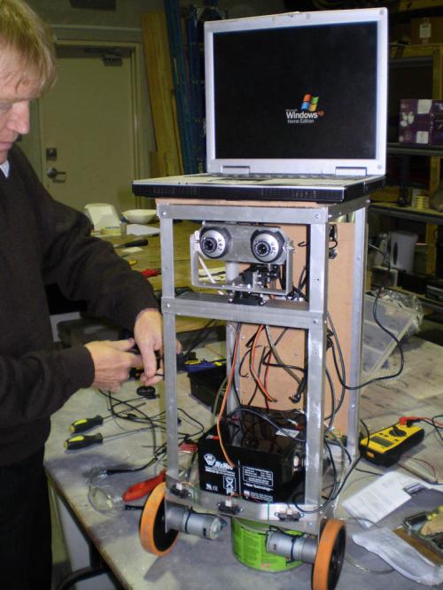

As the blurb says, any character typed through the USB port looks like a key press from the keyboard, so setting up an INKEY$ to accept strings is all I need to send control commands.
Here's the thing.I have one of my old robots handy. I'd like to use the maximite to read the analog IR distance sensors, read the wheel encoders and generate I2C commands to the motor controller (I'll bit bang the I2C).
The maximite calculates the cartesian position (XY) by periodically reading the wheel encoders and deals with low level obstacle avoidance by checking the IR sensors. The maximite also sends the XY position to the PC so I can display it's position on a map.
Why not get rid of the PC you say, a very good question. I need the PC to handle the stereo vision head that generates high level obstacle avoidance and localises the robot
based on landmark recognition.
Somewhere down the track I'd get a little 7 inch vga monitor and drop the vision system as I don't need it on this old robot, just to show the maximite running a robot capable of collision free navigation, running a schedule and responding to user input through the keyboard.
