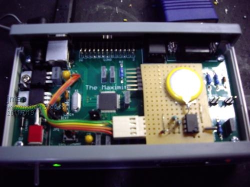

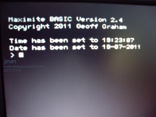

Hi All
As per the other RTC thread I have managed to get my RTC inside the orginal case.
This really cool as now when I power up the time and date is always correct.
This requires Gerard's I2C firmware
I have included the circuit diagram for reference (straight from the datasheet)
2011-07-19_174444_RTC.zip

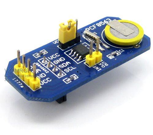

VK6MRG
Joined: 08/06/2011
Posts: 347
Posted: 08:01am 20 Jul 2011
Hi guys,
I thought I'd add my two cents worth about a RTC option.
http://cgi.ebay.com.au/ws/eBayISAPI.dll?ViewItem&item=270741 884749&ssPageName=STRK:MEWAX:IT
I found this on eBay, and should be a straight forward process to integrate into the Maximite.
(I think )
Matt
Edited by VK6MRG 2011-07-21
jman
Joined: 12/06/2011
Posts: 711
Posted: 08:05am 20 Jul 2011
  VK6MRG said   Hi guys,
(I think )
Matt
Looks like the listing has been removed
got a new link ?
jman
Joined: 12/06/2011
Posts: 711
Posted: 08:08am 20 Jul 2011
http://www.ebay.com.au/itm/PCF8563-RTC-Board-PCF8563-I2C-int erface-3-3V-battery-/250846999759?pt=LH_DefaultDomain_0&hash =item3a67a574cf
That links works
Looks very good for small price

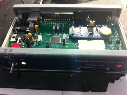

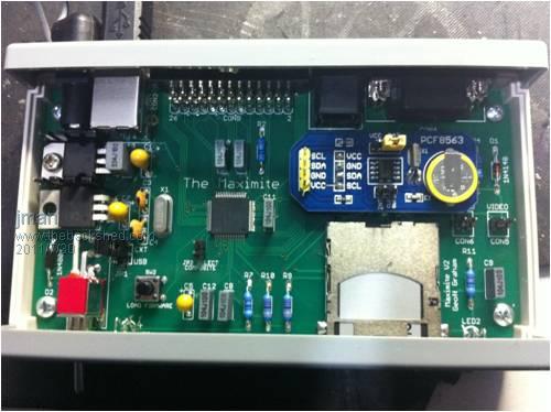

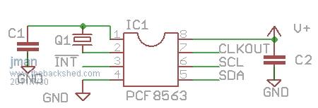

jman
Joined: 12/06/2011
Posts: 711
Posted: 08:20pm 29 Jul 2011
Hi
This device is connected just like any other I2C device
Pin 12 maps to MCU pin 43 (SDA1) and pin 6 on the I/O connector (revised schematic) or pin 21 (original schematic).
Pin 13 maps to MCU pin 44 (SCL1) and pin 8 on the I/O connector (revised schematic) or pin 19 (original schematic).
The PCF8563 has built in pullup resistors to the VCC line so no need for those
You can get +5V from I/O connector pin 23 (revised schematic) or pin 3 (original schematic). A ground will also have to be run to the I2C device (I/O connector pins 1,2,25,26).
This device will also run from 3.3V in that case pin 24 (revised schematic) or pin 4 (original schematic)
Hope this helps
Attached is a circuit diagram ofr the PCF8563
jman
Joined: 12/06/2011
Posts: 711
Posted: 09:35pm 29 Jul 2011
Hi
I have removed the vero board version and installed the PCF8563 Ebay version inside the case
Looks just like a bought one :)
