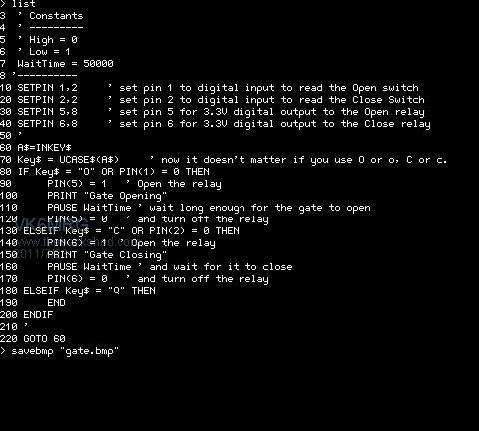

OK, first I have removed the 10 High = 0 and 20 low = 1 as the program works without it. Still trying to get my head around this whole interfacing thing
Second, I have added the WAITTIME = 50000 at the start of the program and changed the program to have PAUSE WAITTIME Looks better, works well. As was said, makes it easier and faster to alter the wait time if needed.

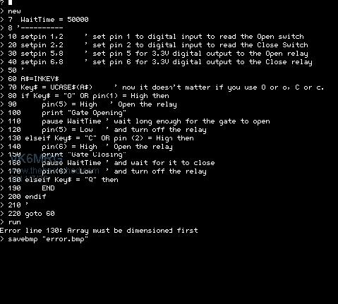

I cut and pasted the program you made up and tried to run it and came up with this error. Any clues.

Posted: 01:40am 23 Jul 2011
  VK6MRG said   James,
Yep. My bad. Get rid of the space between pin and ( on line 130.

Posted: 03:30am 23 Jul 2011
Ok, hear it is so far, Thanks James.

220 goto 60
So, if the gate is open and you press "o" or the open button, nothing happens!
If the gate is closed and you press "c" or the close switch, nothing happens!
I'm just testing some limit switches that i have to see if they are suitable, but a magnet mounted on the actuator and an N/O reed switch is all that’s required.
VK6MRG
Joined: 08/06/2011
Posts: 347
Posted: 04:46am 23 Jul 2011
I need to remove the PAUSE statement and have something like WHEN pin(3) = high (or low) then GOTO (or whatever is next to be done)
Any ideas?Edited by VK6MRG 2011-07-24
