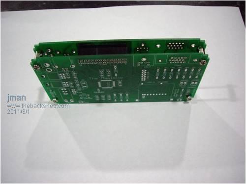

Hi all
I was wondering if any of the PCB gurus out there could come up with a PCB for
inputs outputs etc that plugs into a Maximite see the Pic.
This PCB is the same size and shape as the current Maximite PCB
with a 26 IDC connector mounted on the bottom in a DIL header if needed to make the height. Then fit a vertical mount 26 pin IDC on the Maximite so two boards can be plugged togther if the user prefers they can use 2 right angle connectors and a ribbon cable.
On the PCB four or so analog inputs set up with resistors for voltage dividers and some bat diodes for protection. ie 2 resistors and 2 diodes per analog input maybe a 3.3 zener just in case (optional). 2 or so pins setup with 1 resistor to +5v for LM35Z temperature sensor use and 2 or 4 depends on space SPDT relays all this comes to the front edge and connected via PCB monuted screw terminals
I am sure we can squeese an RTC in there to
This way we just pick the resitor values and we are ready to measure analog !
I have add a pic a shield with screw terminals

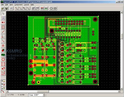

This is a an expander that I have drawn up to have made for my farm gate opener project.
6 digital inputs,
4 digital outputs, 2 relay and 2 transistor switched.
Designed to plug onto the Maximite EV (MINI)
PS. still a work in progress.

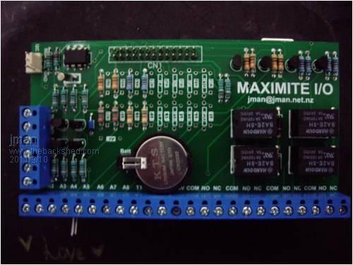

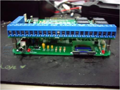

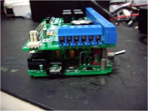

So I got PCB's made for my requirements
This plugs into the Maximite (Header on Maximite is a straight type)
My PCB layout skills are not the best but the boards work ok.
Specs
Real time clock
4 relay outputs
4 Digital inputs (Transistor)
10 Analog inputs 2 of these are setup for LM35 temperature sensors.
Analog has divider just pick resistors to suit your input voltage
I have 2 spare boards with real time clock chips (8563) and crystals should anybody
want one @ around $20 NZD (This is pretty much the cost price)

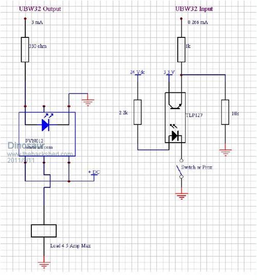

Can you make up a schematic of a single channel opto isolated input circuit and I’ll see if I can add it into my Maximite interface PCB design.Edited by VK6MRG 2011-09-12
Dinosaur
Joined: 12/08/2011
Posts: 361
Posted: 05:36am 11 Sep 2011
Hi All
Below a pic of what I use for the UBW32.
There are better options for the Output opto which is a bit slow on the PVN-012
But I have this working reliably on Machines in Geraldton & Mildura.
Hervey Bay Qld.
