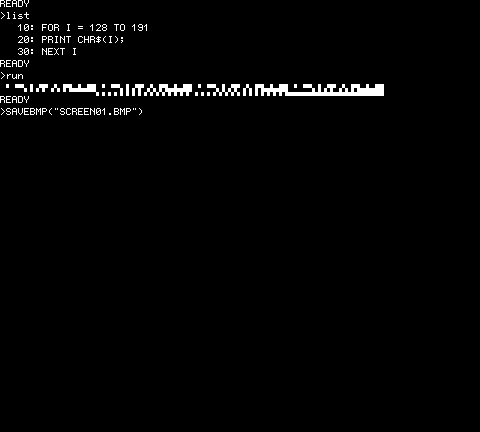

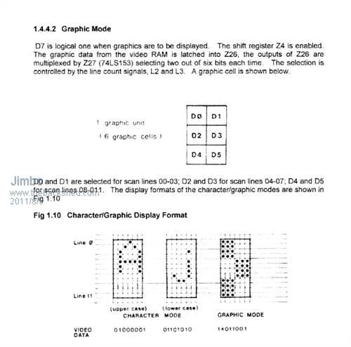

Geoff, I had a Disk Smith System 80, which had the same graphics character set. The graphics where generated via hardware using 6 bits), and here is section from the technical manual.
You will notice that the TRS-80/System-80 Font was 6x12 pixels. Same as the Maximite. 128 Was a Blank Graphics Character, through to 191 which was a solid block.
I have attached a modified copy of my DrawChar.c file, which has the graphics characters added.
2011-08-05_193017_DrawChar.zip
Plus a screen shot of how it looks.

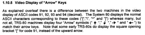

A reference to the special TRS-80 Characters. From the System 80 Technical manual.
