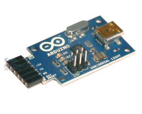

Can anyone tell me if this is useable on the Maximite .... a USB to Serial Converter
www.coolcomponents.co.uk/catalog/product_info.php?cPath=50_7 4&products_id=761&osCsid=93413e9d8a2642cd27a72c3426a1a2bb
Keith
The more we know, the more we know we don't know !

Arduino USB to Serial Converter
Stock Code : 000761
LIVE - 3 units currently available
This board converts a USB connection into 5 volt TX and RX that you can connect straight to the Arduino Mini or other microcontrollers, allowing them to talk to the computer.
It features the ATmega8U2 programmed as a USB-to-serial converter, the same chip found on the Arduino Uno. The USB Serial module has an ISCP interface, allowing you to reprogram the chip when placed in DFU mode.
The pinouts on the connector are compatible with a standard FTDI header.
UK pounds 8.80
Keith

Looks nice, but we don't yet have an RS-232 port to connect it to! I did the mods today, will let you know how it goes.

haiqu
Bob is trying to implement the serial comms using the existing pins.
I was trying to see if anyone had any idea how to use the USB on the Maximite with an adapter to provide the serial comms.
My approach is based on the fact that the number of pins are limited and may be more useful for other uses that USB won't allow.
Keith

Keith,
The adapter you showed us attaches to USB on the PC end and an RS-232 port on the Maximite end. It still needs some sort of UART available to function. There's no advantage to using it unless you don't have a real COM port available on the PC.
The PIC32 is capable of acting as a limited USB host (USB-On-The-Go) but doing that is more difficult than finding a pair of UART pins available.
Rob
