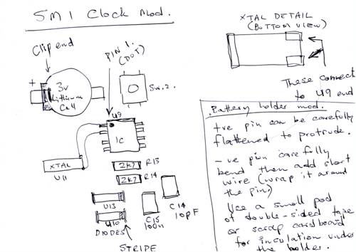

If anyone has had second thoughts about their ability to solder 0603 SMD parts and wants to change their mind, no hard feelings. I did mine today and it came out pretty good, but then again I've also done rework and repairs on the end of an SMD assembly line in the last few years.
I will be including a sheet showing exact parts layout, and also PMing each of you individually to alert that parts are ready. As detailed earlier $7.50 per set, and I'll make it $14.00 for two sets shipped together.

Rather than include instructions on paper, I'm uploading them here for anyone to use:

For those who are about to receive parts kits:
The 10pF capacitor is marked with a black texta so you can tell which one it is. They looked so similar to the 100nF caps that I had to distinguish it somehow.

Thanks Rob
Got my parts today...Another first for me as i havent done surface mount before...;-)
Is there a schematic somewhere which shows you the rtc circuitry...???

Hi Frank,
It's on Don's website as I recall. One thing I found was there was way too much solder on the pads. Clean most of it off with soderwick, tag one end with the iron then solder the other end, and finally go back and fully solder the first end. You'll need tweezers, a clean bench and a maggy lamp, at least if your eyes are as bad as mine.
Good luck, and don't drop the little buggers!

Oh yeah, and if you go back one page there's a layout of the parts on this thread that I posted a few days ago, just in case you happened to miss it.
