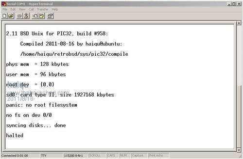

I do actually have a root file system on the card but there's some minor bug preventing it from loading. I strapped a MAX232 to the audio port (UART4) to get the console happening Bob, as described earlier. Quick-n-easy.
This is a port of RetroBSD which was announced only 10 days before I had it working. The author Serge Vakulenko worked on it for a year in his spare time and posted the announcement on 6 Aug to the MIPS Developer website. He's running a UBW32 board but he has a Maximite on order too. :-)
RetroBSD is based on 2.11BSD which was the last of the series for the PDP-11 architecture, and thus supports CPUs without a memory management unit. It has a standard Posix API including multitasking (fork, exec, wait4 etc) and on the PIC32 supports up to 6 consoles (multiuser).

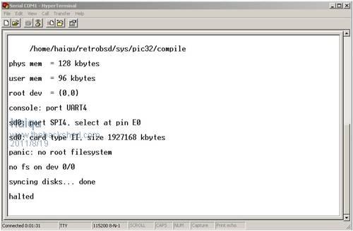

So far I have the whole build done, comms working to the board and blinkenlights. The SD card is seen but can't be read, as mentioned above. I'll be implementing the reset switch tonight and working on the SD card problem some more. Serge just added z-modem protocol to the svn repository for file transfers.

If you're checking out sources, use -r224 because there's a bug introduced after that which causes a memory fault in the MIPS emulator, and probably the hardware too although I haven't tried that.
Also note that my changes to make it run on the Maximite have been sent to Serge but he hasn't yet added them. Meanwhile, you can run it in the emulator and have fun, or load it into a UBW32 if you happen to have one handy.

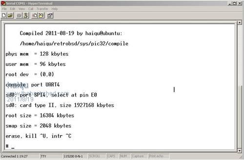

Current sources at -r229 now include my changes and previous warnings about memory faults can be ignored. Still no SD card though ... mutter, mutter.

We're getting there.

Nice to see you found the Maximite forum. I got it working at last!!
