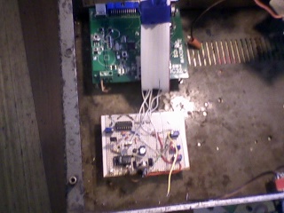

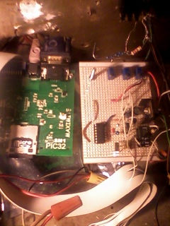

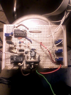

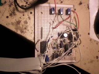

here is the switching circuit working at present....
aargee
Joined: 21/08/2008
Posts: 255
Posted: 12:08am 20 Sep 2011
Sparkey,
What sort of veroboard is that? It looks like double sided (if so, I'm interested knowing where to get it!) or is it just painted strips on the board?
- Rob.
sparkey
Joined: 15/06/2011
Posts: 819
Posted: 03:24am 20 Sep 2011
sorry to say its single sided but i think that its not a hard ask maybee you could cut two pieces and do it that way ..but somebody prolly makes double sided ....regards sparkey...

just cut 2 pieces the same size and just around the corners of the boards add a drop of some type of glue ..superglue and get an aligator clamp or g clamp to whold the bords together and leave it over night ...regards sparkey dont foget to leave the copper sides out ....

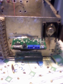

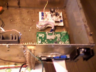

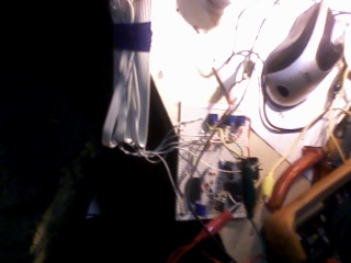

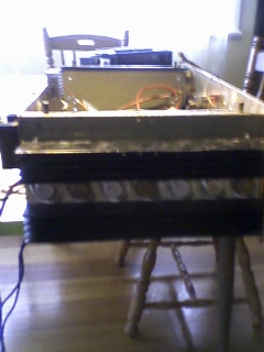

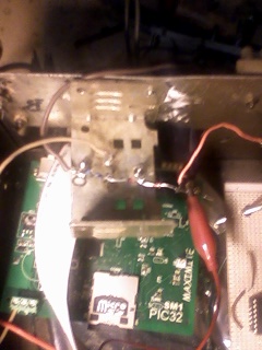

here are some pics with the switching board inserted into the case and a couple of other pics...regards sparkey....still a works in progress have to sort out some pc`s for the small regs yet

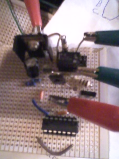

Posted: 06:00pm 28 Sep 2011

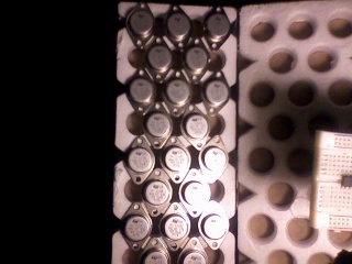

here is the picture of a 2n3055 with 13 volt zenner to give a 13 volt rail as shown its upside down so you cant actully see the 3055 but its regulating down from the main buss 36 volts and also is the 14 volt rail regulator on the black heatsink thjen it feeds a 5 volt reg to power the switching cct....regards sparkey;....
and yes its still aworks in process but it is functioning as you se it here it needs alittle tyding up once i can get it of my bench and onto a table where i have 360 degreese access....regards...

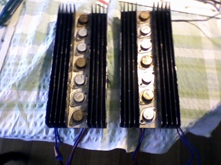

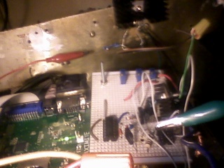

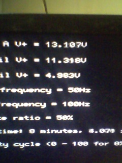

:::this is the discription of the switching cct::::
the maxi puts out the square wave to feed
the 4013 flip flop via a 100nf bypass cap
from there the outputs of 'q' and 'q-' are fed to the two bd 139 npn transistors
the outputs are then fed into the relay
the relay has a charge up cct time before the outputs are activated
reason for this is to give the maxi time to load and run the "pwm" program
so as to stop the out put running free
the transformer is a centre tapped 64 volt hence to say that the collectors of the array tr`s are connected on one bank at the outer sides of the transformer with the centre tapp connected to the input positive from the battery`s and the emmittes connected to negative "gnd"...two banks required ..this gives a modified square wave out put...
the outputs from the relays are fed to the bases of the two sets of output drive transistor banks for the main chopping voltage and current
switching of the heavy currents feeding the transformer....
there is a leak feed to a 1meg trimpot via a 100nf bypass cap off pin 1 "q" so
that reads the output back to the maxi mite frequency counter this
gives the correct frequency of one half cycle
that is "output is at 100Hz ,,so the report freq is 50 hz this is the tru freq
at the 240 volt line well very close to 50 hz ..i`m not game to try latching the 240 volt to the maxi so the output of the 4013 will have to suffice...
you will also notice the three trimpots they are for reading other voltages around the circuit and reporting back to the maximite....

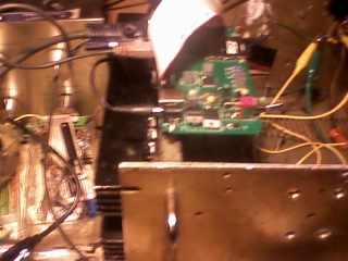

here is the finished board except one voltage rail which i am yet to decide what that will be

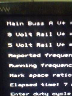

here are some of the disply pictures sorry about the way they are taken but i only have my mob to take pics.....
Edited by sparkey 2011-09-30

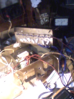

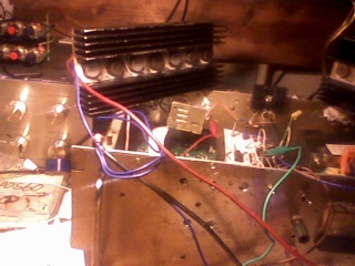

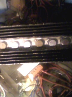

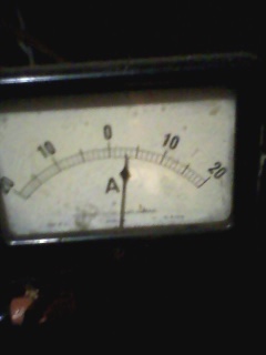

new pics here are some more picks the only thing running off my batterty`s is the computer here is a pict of my main amp meter and yes its wired backwards ..never bothered to change the poles round also you can see the altron driving the switch board cct and a rear look at the transistor array ..i also use a "k-v-m" switch with the mouse plugged straight to the "pc" and the kb and vga plugged to the maxi so i can switch from either...

also i would like to add that at present running the inverter itself and the maximite and the computer and 19 inch "l.c.d" screen and the kvm switch i am using aproxx 4 amps from the batterys ...in the day time i am usually getting an average of four amps from green power....regards sparkey......

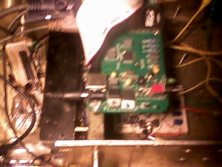

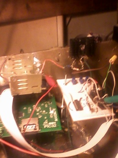

here are hopefully the final photos of the inverter with the boards mounted correctly and still a couple more to come but this should be the last pics....all hail "murphey"...

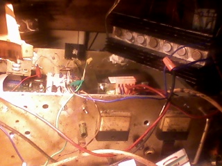

atm i only have my altronics version running the inverter heres a couple of pics

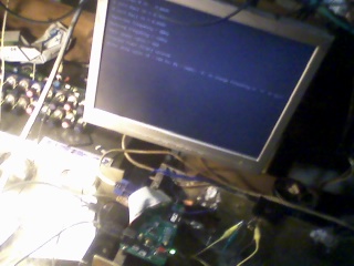

here`s my inverter and screen shot sorry about the qualty but thought some would app the whole box and dice
