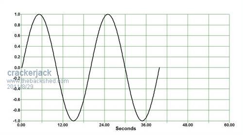

Hi all, some weeks ago there was a post which mentioned ModCom software to allow for putting a GUI facade onto the Maximite (of course running on a PC) via serial. I mentioned in that post (which incidentally, became quiet a nasty series of posts if anyone recalls), that StampPlot would possibly enable a similar GUI face - at the time I had no Maximite, so was really just taking a punt. Now my MM is running, I was able to download StampPlot and after a few minutes of setup and sniffing the output of the maximites via serial using Portmon - presto! StampPlot Pro is plotting the output from my delightful little MM very nicely indeed. See attached screenshot. StampPlot allows for macro's and all sorts of possibilities exist. It's free for hobby use and US$25 for professional use. I am not affiliated in any way.

What I am using is serial over the USB and its really very simple. Using PRINT and INPUT$ statements from the MM and then using 9600 8 N 1 over a COM port to the PC. So instead of just using PuTTY, I'm using other software on the PC to communicate with the Maximite.

A very simple StampPlot example follows:
[code]
10 pi = 3.14159265
20 d2r = pi / 180
30 FOR x = -360 TO 360
40 PAUSE 50 ' Don't overload StampPlot's buffer
50 ? SIN(x * d2r)
60 NEXT
[/code]
This results in the following plotted graph:
Using a StampPlot "macro", it is very easy to read values from the PC to the Maximite too.
StampPlot has as many features as ModCom (and then some), for example meters, dialog boxes, alarms, and many others. Give it a try...
