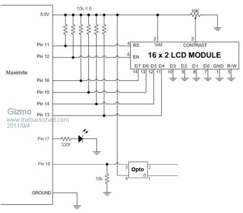

I put together a little tacho program and circuit for the Maximte yesterday.
I needed to quickly measure the RPM of a alternator I was testing ( http://www.thebackshed.com/forum/forum_posts.asp?TID=3504&PN =1&TPN=11 ) and my usual tools were letting me down.
I do have a Oatley Electronics K117 opto-tacho kit, but it needed calibration and was very slow to respond, I no longer have a copy of the instructions, plus Oatley dont have them on their web site either unfortunately. But the K117's optic circuit was working, and it flashed a LED for each revolution of the alternator.
So I connected the LED to a opto coupler, feeding pin 18 of the Maximite. On pin 17 I conneced a LED, to flash with each revolution, and on pins 11 to 16 is a LCD module. This circuit is copied from the LCD.pdf file, with a few additions on pin 17 and 18.
The LCD module displays the cycle time in ms, the duty cycle ( LED off in this case ), the frequency in Hz and the RPM.
Here's to code. Its mostly the LCD routine included with the Maximite samples, with the tacho routines from 100 to 400.

Ray B
Joined: 16/02/2007
Posts: 219
Posted: 01:59am 04 Sep 2011
Excellent example of what can be achieved with a MM and something well documented from which others can learn. We need more of what has been achieved.

Posts: 5203
Posted: 11:42am 04 Sep 2011
Thanks guys. I do see the Maximite as a tool more than a computer, and its perfect for little applications like this, lots of I/O pins and easy to program.
There is a little timing problem I'll look at tomorrow. It reads fast. At 1.6Hz it reads 1.8Hz, and it gets worse as the frequency goes up, at 8.7Hz its reading 15.6Hz. Maybe a timing issue in the Maximite, though the DO WHILE PIN() loops are not the best way to do this sort of thing. I might look at using the interupts instead.
seco61
Joined: 15/06/2011
Posts: 205
Posted: 01:05pm 04 Sep 2011
Hi Glenn.
Yes, you will definitely have to move to using the interrupts.
In the current code, the StartTime variable is being set after the LCD update routines. The LCD update routine (and associated calculations) will take a relatively constant time. The faster the pulses arrive, the later in the cycle the StartTime value is set - therefore giving a "shorter" TotalTime. Hence the frequency increases....
Gerard (vk3cg/vk3grs)
Talbit
Joined: 07/06/2011
Posts: 210
Posted: 01:55pm 04 Sep 2011
Gizmo,
How does your LCD circuit work, because it's wired up incorrectly? See Geoffs' latest circuit. He has corrected his mistake.
Talbit
Talbit
Posts: 5203
Posted: 10:14pm 04 Sep 2011
Ah, yes, your right, I just grabed the circuit from the original PDF, but as you said its wrong. My LCD is wired up correctly. I'll update that imaage later.

Posts: 5203
Posted: 11:36pm 04 Sep 2011
The circuit diagram is correct now.
