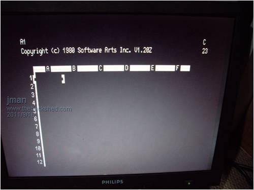

Hi Ken
When i load the TRS80 firmware the Maximite does not start
and the Power LED remains off.
I have it set for VGA of course.
It is NOT usb powered
Any ideas ?

ksdesigns
Joined: 25/06/2011
Posts: 143
Posted: 01:22am 16 Sep 2011
Nick give this one a shot just the hex file
i centered the screen so should work for lcd's better.
still does not have the led lit up was more worried about the video
emulator hex file
ken

jman
Joined: 12/06/2011
Posts: 711
Posted: 04:23am 16 Sep 2011
Yip
Got video on my LCD now
jman
Joined: 12/06/2011
Posts: 711
Posted: 05:23am 16 Sep 2011
I just could not resist
VisiCalc
jman
