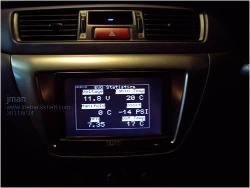

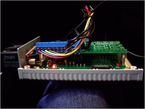

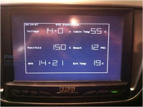

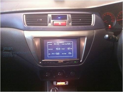

So the I/O PCB I made was primary for this project
I fiited a car PC a while back so the screen was allready there.
As this screen has the VGA connected to the car PC I have set the Maximite
to composite video and with a quick button press I now have a display of the
vitals courtesy of the Maximite

Fantastic, Congrats...
but 55deg Celcius for cabin temp is COOKING...
MickEdited by bigmik 2011-09-19
jman
Joined: 12/06/2011
Posts: 711
Posted: 09:04am 18 Sep 2011
Yip that one is still has no sensor on back order :(

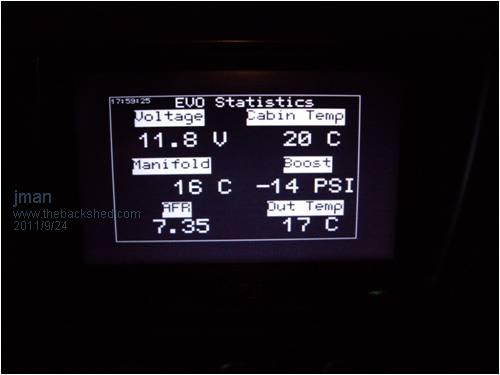

Hi
Some updated Pics using the new Font command
