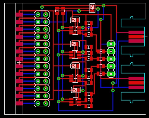

so i figured i would make a board with a dac on it to play wav files
did a rough design and added 4 12bit I2C DAC's and 2 Wii Controller ports
has 26 pin edge connector to plug in to the maximite so you don't need a cable
will try and build one this week

It uses a microchip MCP4725 DAC
• Fast Settling Time of 6 μs (typical)
• External Voltage Reference (VDD)
• Rail-to-Rail Output
• Low Power Consumption
• Single-Supply Operation: 2.7V to 5.5V
• I2CTM Interface:
- Eight Available Addresses
- Standard (100 kbps), Fast (400 kbps), and
High-Speed (3.4 Mbps) Modes
• Small 6-lead SOT-23 Package
• Extended Temperature Range: -
so its good for a lot more than audio
that's why i added 4 of them :)
and for the Wii controller you can use the classic one for games
or the numcuck one you get a joystick and a
STMicroelectronics LIS3L02AL 3-Axis MEMS Inertia Sensor
ken

Would you be able to post a circuit diagram of the sound/game controller module? I was going to design one so I could use the Maximite as a sound synthesiser. As for colour graphics there's a module (the PICASO) that you can get from Sparkfun that lets you send it serial data and draw stuff on the screen. Here's the link: http://www.sparkfun.com/products/10329. It's about US$59.95, though, so it's a bit of a pricey solution.

if you want a easy way sparkfun sells a breakout board for the dac
Sparkfun MCP4725
for about 5$
