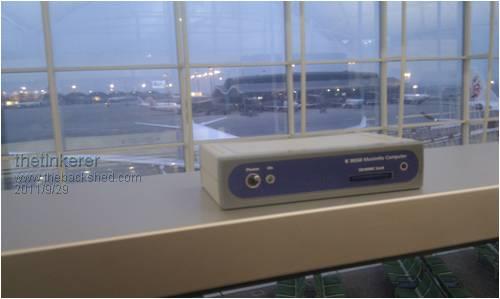

Hi Geoff,
Thanks for all the great work and Version 2.6D feels like a great leap forward.
Just an idea. I am currently travelling with my maximite! and when typing in a command and typo is made there is no backspace at the command prompt. An example would be if we type load"..." and make a mistake the whole line has to be retyped or is this that only occurs through using putty?
just a thought and thanks.
Marc
PS: here is the maximite at Hongkong airport:
The maximite has now been powered up over mongolia at 35000ft and has visited the London bridge, and Paris!
Posts: 3373
Posted: 08:56am 29 Sep 2011
I love it, the Maximite travels the world !!
Your problem is with PuTTY. Do this:
PuTTY Configuration -> Terminal -> Keyboard -> Backspace key -> control-H
All other software uses CTRL-H for backspace, I don't know why putty does not default to that.
