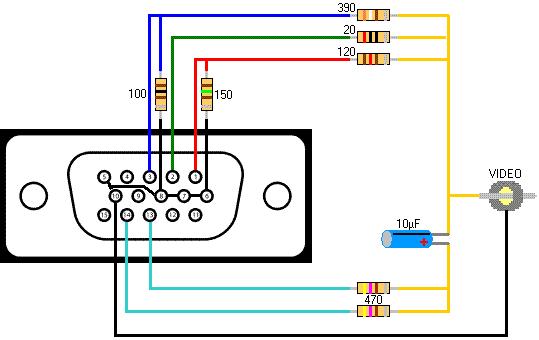

im shure don showed me a pic of a vga to comp adaptor i remember it its in this forum some whare there is a photo of it ..i like the pic`s cool i wonder if you would do any better trying to just mod your own vga plug and using a rca socket for the output it cannot be too difficult and the sm1 its not a bad unit...///.../// greg i sent don a pm explaining the adaptor and what it looked like ...see if this jolts his mem ...but even with this adaptor there still may be limitations....Edited by sparkey 2011-10-30

]greg check my spot there may be something of interest.../// Edited by sparkey 2011-10-30

Thanks for the schematic sparkey, of course with the MM it's much simpler to jumper U4 and connect U5 to the RCA plug. But I can see where it can be useful if you don't have a composite output.
