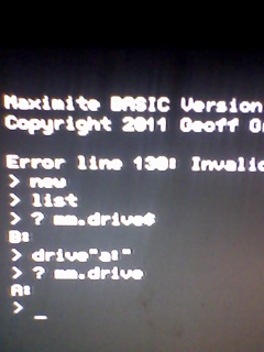

i have read that hyper terminal wont send files to "DRIVE A"
IT CAN BE DONE BUT ITS A LITTLE TRICKY
read this whole article before going ahead....important....
ok open up a hytrm at 9600 using what ever com port you have allocated to the silicon chip com port call it maxi and select a picture ... open it ...
hit the space bar you should be logged onto the maximite now
check to see which drive you are logged onto ...log onto DRIVE A ...
type " XMODEM RECIVE "set.bas" example name given here....
enter
these following steps must be done before the connection times out
you will be seeing dollar sign`s going accross the screen....this is the counter ...
make shure you know where exactly your file is on your pc-hdd ...
in the hy-term select transfer
select send file
when the browse screen appears select your file to be transfered
select :protocal::"xmodem"
select your file ..click send ... all these steps must be done before the dollarsigns stop counting if you have done this correctly your file will start to transfer to
DRIVE A ..... ..regards sparkey....///...//Edited by sparkey 2011-10-28

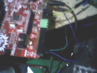

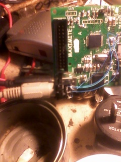

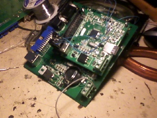

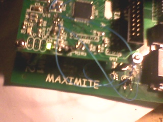

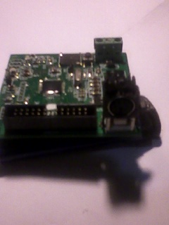

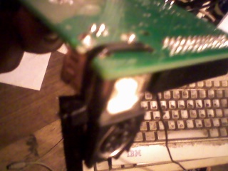

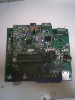

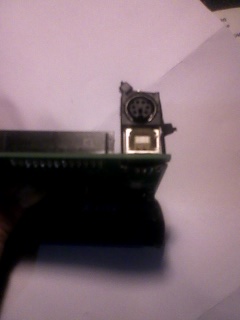

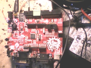

some pics of my modified maxi "ev" thanks to don for the board its not one of his new boards its an early model i have cabletied the k-b sckt on top of the usb port and added the approite pins so i can get compisite pal out of it more pics to come later...yes you could call it "boredom" but nesessaty is the mother of invention...enjoy...///...///
key board connected and working...
Edited by sparkey 2011-10-30

Posted: 01:35pm 29 Oct 2011

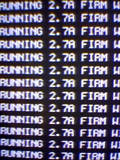

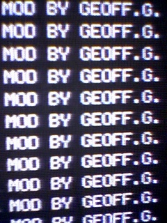

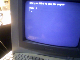

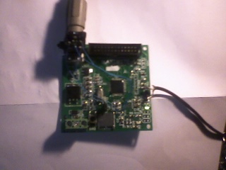

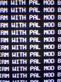

ok here we go i have the k-b connected running of compisite pal ...will connect up the vga and a comm port when i get the connectors and here`s some pic`s regards sparkey ..enjoy...///
sorry about the focus i only have a mob phone as a cam and it dont like crt`s much but here ya go....////
just a few more pic`s showing that geoff`s pal mod works and seems quite steady....///...///
Edited by sparkey 2011-10-31

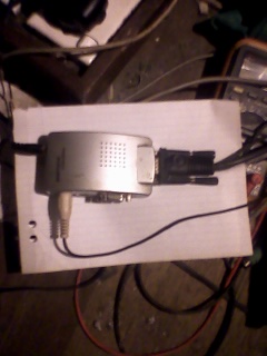

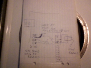

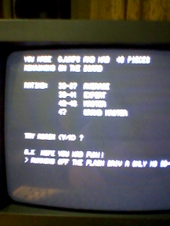

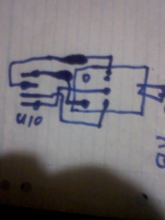

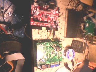

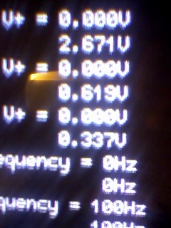

heres the hex file gerard and the code 2011-10-30_114638_invtr.zip the picture is like seeing double one on top of each other but double readings...///
thank you here is a picture of my pal to vga converter and also a pic of this running my lcd screen...///
this is the k-board wiring i`m soorry about the quality of the pic but enlarge it and u will get the wiring only four wires ....///
sorry i should mention that i have the kb-sckt fitted up side down with the pins sticking up in the air once you have connected the wires just put a dab of silastic silicon sealent glue over the pins let it dry over night this will keep them from comming off and also insulate it ...

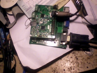

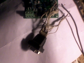

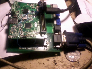

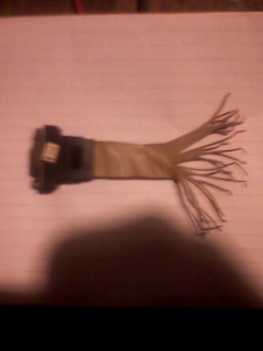

:this is a pic of a vga cable sockt as i am going to atempt to pin it out and connect it to the "ev" board "
well sorry guys i could not get the vga to work there may be some other reason i will have to go over this for a while considering that the comp`s works maybe i did not have it right will keep trying though ...///...///

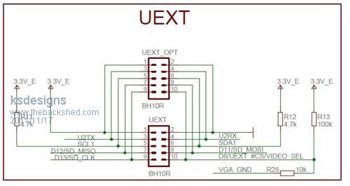

ok now ::there is a mistake in the vga pinouts in silicon chip mag and i think its the reason i failed in my attempt::::march silchip shows the "horiz" connected to pin 12 ...and nov shows it connected to pin 13 i think 13 is prolly correct considering this board that i am using has never ben used for vga video before...regards ....pin 13 is correct houston we have vga liftoff...
given it is a little messy i connected the ground and video feed straight to the pal hedder and the horiz & vert to the board its still prototype atm but will neaten it up as soon as i decide how to...lol...///...///
well i am going with the compisite output as the resulution of it is some what larger in pixels....and this pic is for gerard...

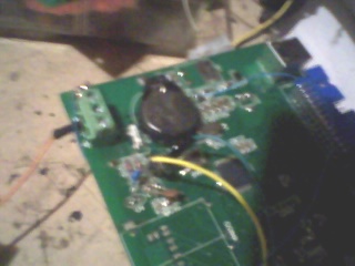

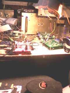

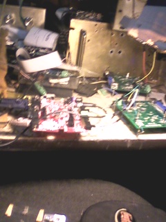

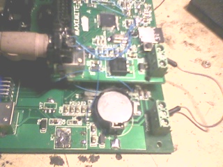

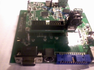

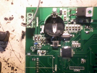

after looking at pins 4 and five on the sm1 cct i see that they are pinned out to "U11" connector on the "ev" board from don so i am
going to mount my ev board to one of my scrap sm1 boards and isolate the rtc from the sm1 board and connect it into the "ev" board as i am going to bolt the two boards together and create a maximite out of the two boards and also i will be useing the vga sckt of the sm1 board but leaving my K-B connector as is and i will have it running my inverter if all goes well i will be sending picks later to day ...ahhh monday arvo project what a perller...regards sparkey...///...//
a better pic.......
Edited by sparkey 2011-11-01

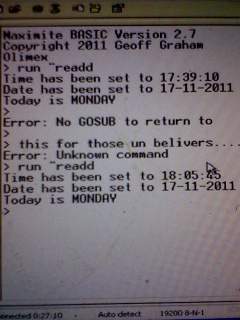

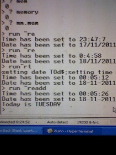

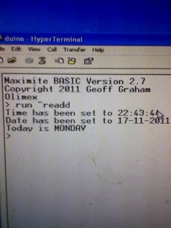

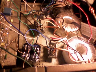

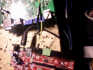

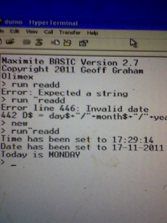

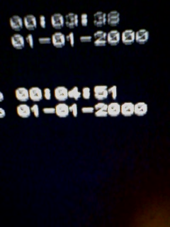

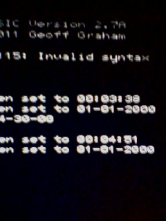

well i have blown up 3 of them ..fist clumsy mistake second,third wiring back with the trim pots wound the wrong way needless to say i use the parts of them for other things and i will prolly use the rtc kitset i have 2 of them complete parts just need to isolate the cct from the sm1 and go from there ...i think that sums it up for you ...so there ya go there not industructable as one might think but in the early days of the inverter the wiring was a mess its a lot better now as i have basically finished it and the maxi is running in pwm mode...regards sparkey...
and here is a pic of it running have the usb for power atm until ifit it into the inverter as it has also the video out hard wired with wire wrap wire its a little hard to se the wires but...i have drilled holes into the tracks to isolate the horiz.vert.video and ran a jumper eatrh from the supply sockests the green ones that extra gnd came in handy after all next is the rtc getting it going as you can see i dont have the key board plugged in atm...regards sparkey...
:;and yes we have left the tower it 3_38 whooo i have the time clock running not really shure how to set it correctly but its working ...here`s some pics...

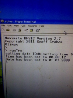

well i `v almost given up on this rtc thing well...one time the read program ran but most of the time i get error line 446 its anoying ..given that i dont really need the "rtc" i`m not too worried ... i have gone over and over it hard ware wise with a fine tooth comb ...ohh well i will still keep at it i must have had something right some time for the read program to read correctly ...???...,...///...///
Edited by sparkey 2011-11-02
sparkey
Joined: 15/06/2011
Posts: 819
Posted: 09:06am 01 Nov 2011

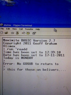

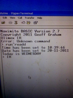

seem`s no body really tells any body just how to do some things well ::
::heres how to set the "rtc"::::
1) powr up the maxi
2) enter the correct time and date:::
3) run the program that does the diag ..the one that lets you know its functioning correct you should get a result of zero here if you do not then something is wrong ...check over everything for faults weather they be hard ware or soft ware...
4) run the prog that reads and sets the time ...
5) you must do this in exact order that is why every body is getting error messages....
6) put the time set program into your auto run list and you should be off and running...
regards sparkey...///...///
VK6MRG
Joined: 08/06/2011
Posts: 347
Posted: 09:13am 01 Nov 2011
Sorry Sparkey, I beat you to it by almost an hour!
Have a look at my post <<HERE>>
Also, the reason I was getting error messages was because of the extra lines added and amended to the READ.BAS and WRITE.BAS files. Once these changes were made, my RTC worked!
Edited by VK6MRG 2011-11-02

step i left out sorry before you nstart take the battery out then after step 6 and you have the correct time and date replace the battery...///...///Edited by sparkey 2011-11-02
