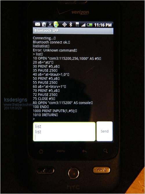

This was using a Olimex UEXT Bluetooth Adapter and the code on the screen

nice :) so now you can not only write your Basic programs with your phone but also you can interract with your program code which is running on DuinoMite with any bluetooth devices with Serial bluetooth profile like mouses, keyboards, printers etc

This would also work with an android tablet that you can pick up for next to nothing from china at the moment! I have one and when I get around to it I'll give it a go.
