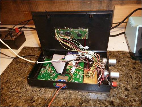

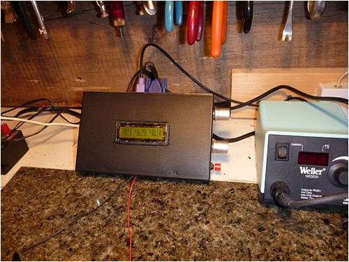

I got my first Maximite Temperature logger completed and running. It is on a Dontronics Maximite SD1 with an added RTC and a 16x2 LCD. Works great. I finally found a use for those old plastic VHS tape boxes. The entire project fits inside.
The LCD displays through the front cover. The two POTS, one to adjust the lightness/darkness of the LCD characters, and the other to fine tune and calibrate the sensor are mounted in one end of the case. So is the micro on/off switch for the LCD back light.
I chose to have it display the date and time on the top line of the LCD and on the bottom line I have the current temp in the middle, the daily low on the left and daily high on the right.
At midnight each night it writes the daily high, low and average to the SD chip. I use this information each year to calculate heating degree days, first freeze, last frost, the growing season length. And I track record annual high and low temperatures. This is all interesting if not useful information for our local community of about 100 people. I put it on our local annual calendars which we print and pass out each December.
It is hard to see the RTC but it is under the cables hot melted into place on the Maximite SD1 board. In addition to being an almost fail-safe data logger, the unit makes a nice temperature display for my shop. Knowing today's high and low at a glance is also a nice feature.
This data logger aspect to the SD chip is going to make my work logging the daily highs and lows MUCH EASIER. Right now I have it running off a 9v one amp power supply but I will be hooking it up to a 12v battery system charged by a PV panel and an on-grid battery charger and conditioner (for those times when the sun don't shine). We have power outages almost every month so this should solve the problems all the resets might cause including loss of part of each days data (high’s and low’s collected before the power went out). Speaking of power outages we have had FOUR today!
I do have a couple questions for those more knowledgable than myself. My Maximite SD1 reads 3.26 volts on the 3.3 volt leg. I adjusted the Basic program so 3.26 is used to calculate the temperature (Being I’m in the US I then convert everything to Fahrenheit). What I’ve noticed is that when I turn on the back light for the LCD the 3.3 volt leg drops from 3.26 to 3.06 volts. This of course throws off the temperature reading as the voltage has changed so much. I can recalibrate with the back light on or off, but then switching the back light off or on again will require another recalibration. Does anyone have any idea why this is and how to deal with it?
My other question shows perhaps how much of a newbie I am. The adjusting POT for the temperature is 10K and is VERY sensitive. Most of the adjustments are right in the middle of the dial. If I wanted to decrease the sensitivity of the POT knob couldn’t I put in a 1K POT with a 9K resistor in series on the middle leg? Would this give me a wider range of rotation on the knob for the fine tuning? Or since I'm in the middle of the dial should I maybe put in a 4.5K resistor with a 1 K POT? Right now using the 10K POT the smallest adjustment or touch to the knob is often too much.
I want to thank everyone for all their help with the RTC, LCD and Temperature sensor programs. I love the Maximite, the SD1 and will be using it for many other projects. This is only a beginning. Yahoo!

Re the LCD power supply dropping can you consider using a 5v supply? This may also deal with your contrast problems with a more stable supply voltage. My statements are based upon the original design MM which has 5 volts available, I don't have the schmatic for the SD1 at hand.

I suppose I could use a separate 5 volt power supply but I didn't want to if I didn't have to. The SD1 Maximite gets it 3.3 and 5 volt rails right off the Maximite. It is not a separate LCD power supply that is dropping exactly, but rather the act of turning on the LCD back light drops the voltage all across the Maximite. It is on the 5 volt rail, but both Maximite rails drop when the back light is turned on. Is this normal? How much current could the back light draw on a 16x2 LCD?
The LCD contrast is not a problem. It works fine with a 10K POT. It is the adjustment to the LM335 temperature sensor via its 10K POT knob that is too sensative. I don't know enough about electronics to know how to expand the turning radius for calibration. Using simple math, which may be wrong, I figured if I was currently in the middle of a 10K POT and it was too sensative, that it might be better to have a 4.5K resistor in series on the middle leg of a 1K POT. To my logic (with little understand of the whole process) I can't help think that this will give me an adjustable resistance range from 4.5K to 5.5K using this set up. Am I right? Will this likely allow me a larger turning arch to achieve a finer adjustment? Right now with a 10K POT all I have to do is touch the knob and it will likely move at least 2 degrees up or down (F) which is too much for real accurate calibration.

It would seem to me that the current drawn by the LCD backlight is causing your voltage to drop - you asked the question "How much current could the back light draw on a 16x2 LCD?"... If you have a multimeter, why not test it to see?
You mention you are powering the setup from an external source - since the Maximite's 3.3V regulator takes it's input from the onboard 5V regulator in that case, have you checked the voltage at the 5V output with and without the backlight on. If the input voltage to the 3.3V regulator drops below 4.75V, anything can happen - see the datasheets for the LM1117T-3.3 for more info.
Regarding the pot... are you using a multiturn preset? This could help.

I appreciate all your suggestions. After some further testing I learned I have a LCD with a backlight that has a voltage range of 3.5 to 4.5 volts. The 3.3 volt rail is not high enough to power it on mine (3.26 volts), and the 5 volt rail at 4.98 volts is too high. Perhaps the LCD back light dumps the extra voltage causing the large drain and voltage reduction across the entire Maximite. When I ran the LCD Back light on 4.5 volts from an exterior power supply it only consumes 115 mA, about the same as my Maximite which draw 130 mA. My cheapo multimeter only reads amperage up to 1000 mA and when I try to test the current load for the entire Maximite with the LCD back light turned on it is overloaded, so more than 1 amp.
I was able to put a 10 K POT on the back light circuit and when it was dialed down to 25 Ohms the 3.3 volt leg on the Maximite only changed from 3.26 to 3.25 volts when the back light was turned on. I don’t have any 25 Ohm resistors, the smallest in my inventory is 100 Ohms. When I put one of those in the backlight power line the backlight is so dim it is almost as dark as being turned off. Guess I need to pick up some 25 and maybe 50 Ohm resistors to round out my collection. Or maybe some small trimpots.

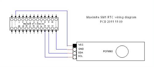

Regarding the request for my schematic, I wired the Real Time Clock SCL & SDA lines directly into via holes on the Maximite SD1 board. I used a PCF 8563 I got on Ebay for $5.50 USD. Wired the SCL to a via on the PCB that traces directly to connector Pin 13. Wired the SDA to a via on the PCB that traces directly to connector Pin 12. You can see these on the bottom of the SD1 PCB if you look closely. I also use Pins 12 & 13 to drive the LCD, but since the clock only uses these SDI pins at startup there do not seem to be any conflicts. The RTC can run on either 3.3 or 5 volts so connect it up to which ever you wish and ground is ground.
I didn’t get to wiring up the clock on my #2 Maximite SD1 last night but will do it tonight. If anyone wants a photo of where I wire these in just let me know and I’ll post a photo to this thread.

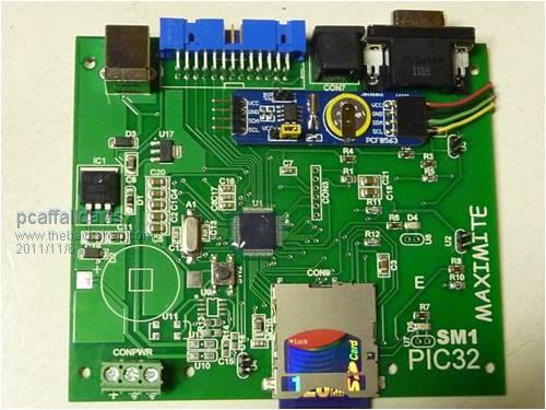

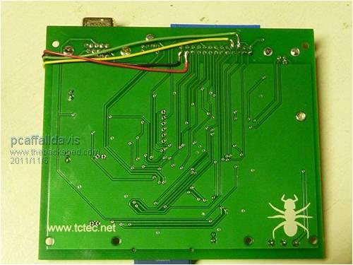

Now for an update. I'm building two more MM SD1's with RTCs. Someone asked how the RTC was wired in. Tonight I had two to do and I put the first one in with the two SDI wires on vias in the PCB and the power lines to the cable connector upper row of pins. Unfortunately this brand new Maximite SD1 is dead. Well, not dead exactly. It will boot and load programs, but when I ask any program to run it hangs. I flashed a newer version 2.7A onto it but same problem. No workie. I don’t know if my soldering the SDI wires to the via holes so close the PIC cooked it a bit too much or not, but does not work. Too bad… I’ll need to get another one now. This is the same way I wired in the RTC on my first Temprature data logger shown in the beginning of this thread.
So, I put the same RTC on my third MM SD1 (photos above) and this time I soldered it to the bottom PCB ribbon pin connector points. It works great. I should perhaps note again that my first Temperature Data Logger with RTC and LCD 16x2 display had the RTC installed to the via holes and that one works just fine. Maybe I got a bad SD1 but it is too late to know if it was DOA or not as I didn’t test the RTC first using jumpers. I’m going to make one or two more of these Temperature Data Loggers with 16x2 LCD displays. They are nice to have around in different rooms just as thermometers showing current temp along with today’s high and low.
