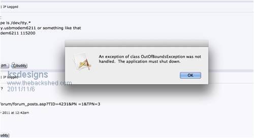

Does the MMIDE program work?
Last comment here:
http://www.thebackshed.com/forum/forum_posts.asp?TID=4231&PN =1&TPN=3 Edited by CircuitGizmos 2011-11-07
ksdesigns
Joined: 25/06/2011
Posts: 143
Posted: 10:47pm 05 Nov 2011
Nope
An exception of class OutOfBoundsException was not handled.
the application must be shut down.
this is on Lion

CircuitGizmos
Joined: 08/09/2011
Posts: 1427
Posted: 11:05pm 05 Nov 2011
  ksdesigns said   Nope
this is on Lion
ken
Hmm. Happens when there is no serial port found by the system.
ksdesigns
Joined: 25/06/2011
Posts: 143
Posted: 11:07pm 05 Nov 2011
its going to have to search thru /dev/tty. some how .
possibly a config screen for it ?
ken
CircuitGizmos
Joined: 08/09/2011
Posts: 1427
Posted: 11:12pm 05 Nov 2011
  ksdesigns said   its going to have to search thru /dev/tty. some how .
ken
I'm using the very same Mac code I used on another serial port project. Worked with a Mac with several Prolific USB/serial attached. I suspect the Maximite does not show up as a serial port the way that the adapters do.
