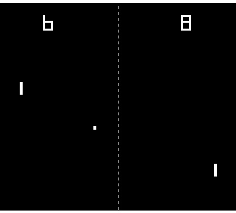

Hi all,
A bit of fun again...
The game of MaxiBlip is a bit of blast to days gone by when simple things held attention for long spans of time. The screenshot below will give you a taste of what I mean....
The zip file linked to above contains all the details to setup the game, paddles and simple calibration required. Check the README.TXT within.
The code gives the Maximite a little bit of a workout - but it is truly a marvellous machine. The whole deal uses 16% program memory, 16% variable memory and 2% string/array memory. It utilises Fonts, Sound, lots of pixel manipulation and even the MPF format file for the splash screen. The paddles (controls) are simple analog devices. Thanks to Geoff for the XMODEM inclusion in 2.7 - it has made working with the Maxi so much easier - ditto for the new editing features and function key assignments.
It was my intention to make the game workable on both VGA and Composite displays, but as I don't have a composite display setup for my Maxi, I wasn't able to verify this. I've left comments in the code where I believe changes for composite displays would be required, but it may take more work than it seems at first glance to get it right. As always, variable names are probably more cryptic than they ought to be and some of the code may leave you pondering why/what/who and when? But maybe not.
Finally, MaxiBlip may have a passing resemblance to a game from the 1970's with a name that stinks and by a company whose name is an anagram of TIARA. Then again it may not.
Have fun...

Nice game for the Maxitmite. Good work Crackerjack. After a couple of tweaks and an addition I have it running very nicely on mine (VGA).
Tweaks are
Paddle movement is smoothed
Redraw the centre line only on serve
Added Difficulty selection to opening screen
Next is to make the computer beatable in player 1 mode!
Am happy to post it if Crackerjack is happy with someone else mucking with his code.
Cheers,
Anthony.

Hey Anthony - that's great. I'd be more than happy for you to post it. As for "mucking with the code" - that's what open source is all about - I'm flattered that anybody would take the time and make the effort to improve, change, adapt or whatever.
I've actually had a bit of fun playing it against my wife - the kids are disinterested - they have no connection to the 70's in any way and to them it seems boring to bat a blip back and forth across the screen (in black and white, nevertheless!).
Cheers mate...
