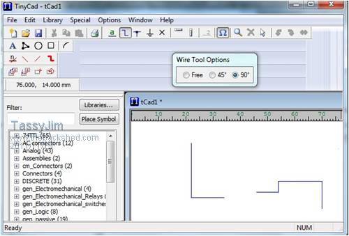

I've just about got the wood fired boiler schematic completed. It should be done today or tomorrow. I've been building it with the components on the bench and testing them using small BASIC test programs as it goes together.
I have a question for someone with TinyCAD experience. Is there a command that will cause the wiring lines to remain straight when length adjustments are being made. Like when you need to extend a wire line? I seem to be spending a lot of time zooming in until the schematic is huge and then adjusting the lines so they remain straight.
Some drawing programs give you the option of holding down a certain key while you drag a line to keep it perfectly straight rather than allowing it to go diagonally. Is there such a key combonation for this in TinyCAD?

Pete,
When you select 'Wire' using F2 or the button, A wire tool popup should appear with free, 45 or 90 degrees as the choices.
I did have a play with TinyCad a few years ago and it one of those thing I will get back to 'soon' (soon as the BOSS stops giving me more thing to do around the house).

Thanks TassyJim.
I've learned that it is best to get the line right the first time as adjusting it does not have the 90 degrees locked in. I can do any two segment lines fine, as TinyCAD handles this automatically. I just have not yet figured out how to draw a three or four segment line, and so I often have to go back and try to lengthen one of the lines where I didn't join the segments up exactly right the first time. Adjusting ends is where the entire line or one end of one goes off the 90 degree grid. I've about learned to do it two segments at at time though.

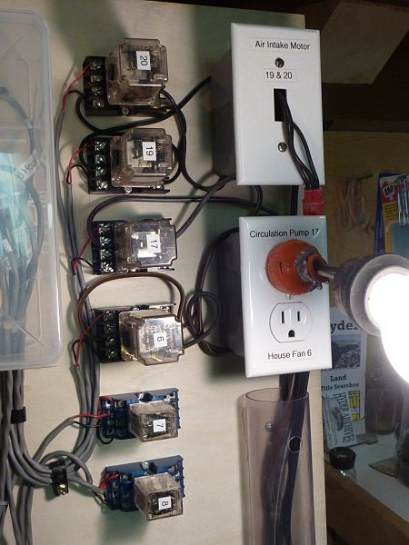

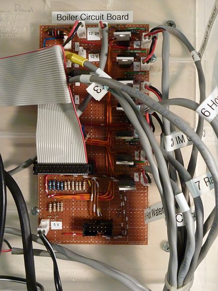

Got the design for the PCB done. All the low voltage connections 5, 12 & 24 with electronics fit easily on a 9 x 5.5 CM board. I managed to put 9 Mosfet switches and five connection points for temperature sensors. Still room left over. I will be putting 2 pin connections to PCD headers for all the relay and solenoid circuits as well as to each of the temperature sensors. Got a 26 pin shrouded header to connect it all to a MM SM1. There are also two 2 pin connections to headers for 12 V and 24 V power supply connections.
I'm about done cutting the board and will start putting on components soon. I had to order in the 2 pin headers and connectors plus the 26 pin shrounded header so I can't do it all this week. Bummer. I have everything else.
I don't plan to mount the MOSFETs to any heat sinks, but the only one that will be closed much of the time is the one that is sending 24 volts to the circulating pump relay. I'm no expert on electronics (as most of you can tell), but does anyone think that leaving these MOSFETs free standing with no heat sinks will be a problem?
All are either driving 24 volt relay circuits or 12 volt computer fans to blow air into the firebox for 5 minutes each time the intake vent opens, no big load I don't think. Am I correct? Or should I think about finding a way to lay some of them down or attaching them to a heat sink?

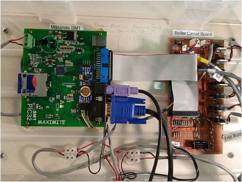

I've been plugging away. We had four feet of snow this past 10 day stretch and have not been able to get mail (float planes can't see to get here through the storms). I have most of the add-on board done, but I accidentally ordered extra 10K resistors when I needed 10 Ohm resistors. So I can't quite finish it up yet.
The add on board is about 1/3 the size of the SM1 so it is pretty cramped. I spent the day testing the four temperature sensors sections of the PCB. Those don't require any 10 Ohm resistors. That took all day 'cause I didn't see the tiny specks of wire or dross that had fallen between two lines shorting out two of the four temperature sensor connections points. Some days are like that.
Tonight I'm going to test the LCD connection point using another 16x2 LCD that arrived. When that is done I can't really do anything until the 10 Ohm resistors arrive. Then I should be done with the PCB and will start on the line current panel with all the relays. I'll post photos of the small PCB when the resistors arrive. I used the type of prototype board that has rows of etched holes. I use a knife to cut the rows as needed so I have sufficient holes in a row to jumper each grouping of components. The back side has about 30 jumper cables, but the front looks pretty clean. I am using two pin headers and two pin connectors to connect all the relays, 12 & 24 volt exterior power supplies, and temperature sensors.
I'm using a 26 pin connector on the board to connect it to the SM1 and I'm using a 10 pin connector to jump it out to the 16x2 LCD. That's about it. We might get mail on Monday and if we do I'll have the photos of it next week.
Thanks for asking! I'll keep you posted.

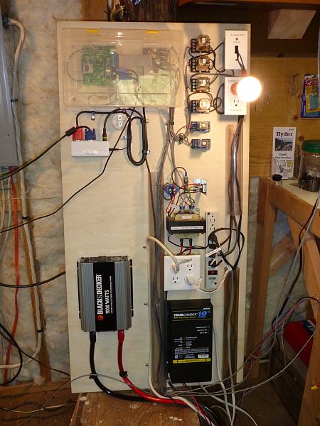

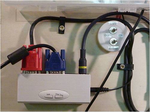

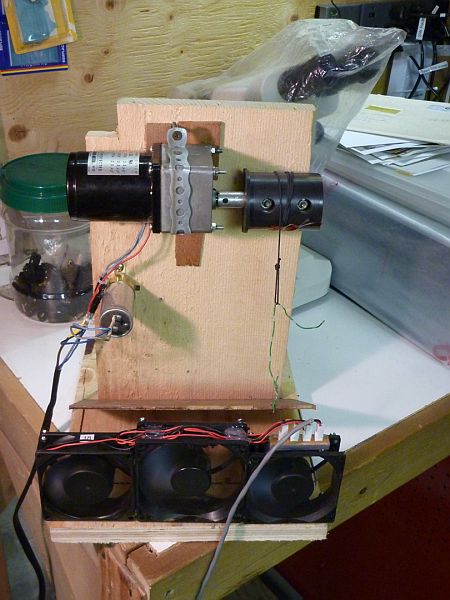

pcaffalldavis
Joined: 17/10/2011
Posts: 187
Posted: 05:56am 01 Jan 2012

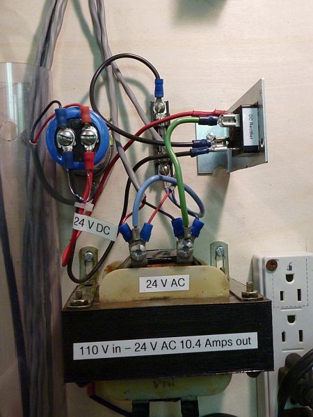

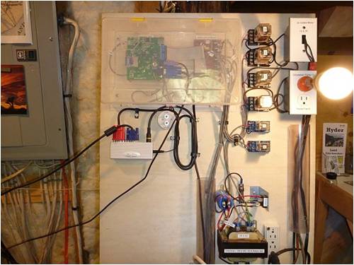

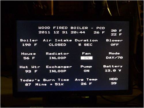

Here is a photo update of the Wood Fired Boiler Control Panel. I'm uploading nine. If they don't all get through I'll try sending them in additional posts.
The TFT monitors are still not here, but I have a VGA to composite converter shown in one photo. It is running and sends the screen display into our CCTV security system. A photo of the display is included in the group.
You can see a 10 pin connector on the Boiler Component PCB. I ended up not using it instead favoring the VGA to Composite converter.
The last photo shows a shop mock up of the air intake for the fire box. It opens when the water temperature gets down to 170 F, the air intake opens, and the fans will blow for a set period of time to get the fire up to temp quickly. Then the fans stop and the intake remains open until the boiler temperature gets up to 190 F at which time the air intake closes. Hot air is drawn off in the house through the radiator and hot water heat exchanger as needed until the boiler water temperature drops back to 170 and the entire process starts over again.
HDD in the display is the number of Heating Degree Days for today. This is a standard used to compare efficiency and heating costs of same or similar structures in different climates. Heating Degree Days are usually added for an entire heating season (in NA that is Sept 1st through Aug 30th). HDD’s are also a good way to determine at which outdoor temperature your home heating system is most efficient. Kind of like finding the most efficient driving speed to fuel consumption ratio. It will be nice to know at what average outdoor temperature our boiler is most efficient at keeping our house the desired temperature using the least amount of fire wood per HDD.
If anyone has any questions please don't hesitate to drop a note or ask in the group.

centrex
Joined: 13/11/2011
Posts: 320
Posted: 09:03pm 02 Jan 2012
Hi Pete
That is very impressive, although I dont know if an electrician saw it he would be impressed.
But it is your design and the beauty is if it doesnt work quite as expected you can get in and do something about, not so if it was a turnkey system.
Keep up the good work, MM forever.
Cliff
