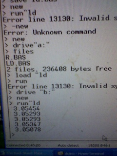

Posted: 10:49am 21 Nov 2011
ken i have no other way of sending you this so have a close look...

Posted: 02:14pm 21 Nov 2011
file is at:
http://www.themaximitecomputer.com/max/Programs/Hardware/Don tronics/LCD/2011-11-17-DuinoMite-Version.bas
code runs fine on MM-DM, and drive B:
If you save it to drive A:, and load it back in, then under the old firmware it deletes two characters in line 13130, and errors.
With the latest firmware, it errors on a different line, but with a similar problem.
Mick has verified that he has the same error, and we have reported the bug to Ken.
It looks like Ken has made drive A: 32K, so this may be part of the problem.
