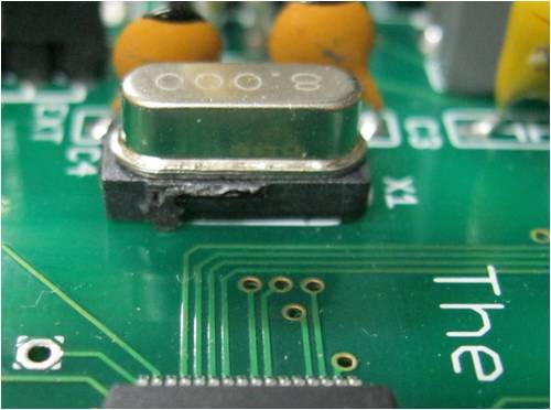

larny
Joined: 31/10/2011
Posts: 349
Posted: 02:56am 20 Nov 2011
  sparkey said   also check that u dont have the xtal shorted to close to the pcb i cannot rember what fault this produces but it can short to the pcb if you dont leave a mm between it and the board...
I mounted my Xtal on a "chair" made from part of the plastic insert that was inside the SD Card socket as supplied in the kit.
I cut the best part out with scissors & drilled 2 holes.
Here is a photo
Len
