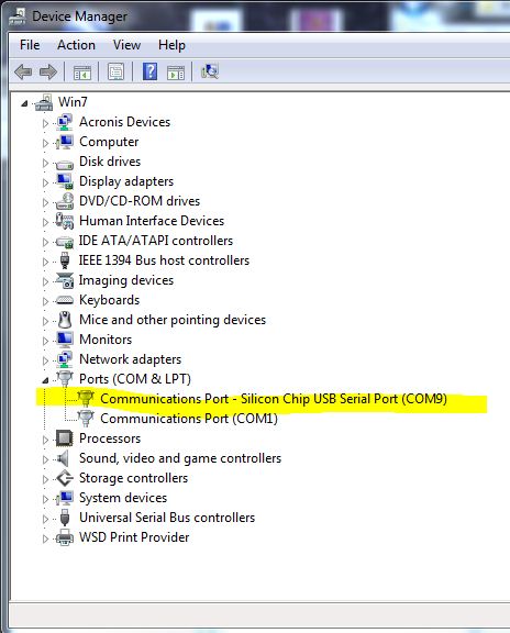

Keith @
Joined: 19/06/2011
Posts: 167
Posted: 07:18am 27 Nov 2011
Elchucko
here's what I see under device manager in Windows7 ... I've highlighted the item
You may have to try a couple of times and disconnect the Maximite between tries before you get it to work .. I have encountered this with some other devices but not the Maximite.
Once you see this item in devices (note the COM port number for future reference) then you can proceed with the bootloader application and updating the Maximite to 2.7B
Keith
The more we know, the more we know we don't know !
