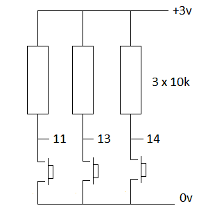

This time i have do a little moon lander.
For this one you need 3 buttons
Up on pin 11
Left on pin 13
Right on pin 14

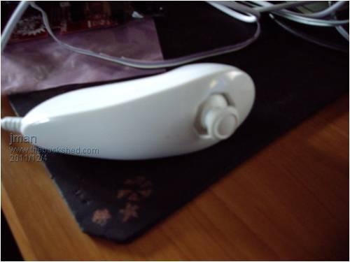

Hi
I added the Wii numchuck code
So now i can play this with my $3.50 numchuck
All the wii variables are still there so maybe somebody wants to make it
go with the accelerometer
Jman

jman
Joined: 12/06/2011
Posts: 711
Posted: 07:06pm 03 Dec 2011
  VK6MRG said   Could someone design a game controller interface for the Maximite?
We allready have one take a look at this post
NumChuck
