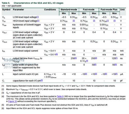

Regarding I2C SCL SDA input voltage specifications.
The data sheets for I2C devices that I am now using, from STMicro, NXP and Maxim, all specify the input high level (minimum) at 0.7 of the supply voltage. That is 3.5 volts required input with a 5 volt supply to the I2C chip.
I think an inadequate margin with only a 3.3 volt supply to the SCL and SDA pull up resistors. Yes it might work, sometimes.

  Keith W. said   Regarding I2C SCL SDA input voltage specifications.
Keith W.
From the I2c spec
I2c Spec
[1] Some legacy Standard-mode devices had fixed input levels of VIL = 1.5 V and VIH = 3.0 V. Refer to component data sheets.
ken
