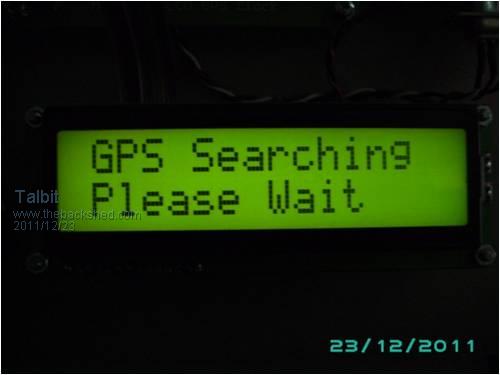

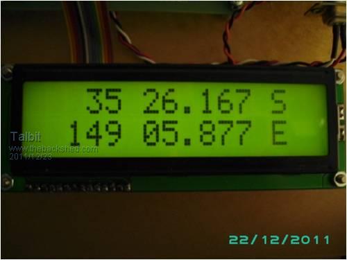

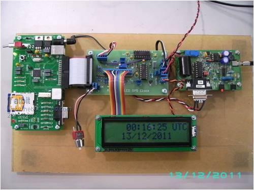

This is the latest version of my GPS Clock. Please refer to my original post on 26 September for more info on the concept.
The main improvement is the addition of a push button which gives a display of the position.
The clock uses a Trimble ACE 3 module set to deliver the NMEA string at 19200, 8, N, 1.
The LCD routine is unchanged from Geoff's original code. It also uses his parsing code to extract the relevant information from the NMEA string.
Thanks to all who contributed help on my code hang-ups!
I’ve also attached a circuit diagram and have built the PCB.
It works like a charm.
Not that the Alarm (Time Break) now appears on pin 2 and not 18 as in the original design.
Pin 18 now controls the PPS LED. It only enables the LED when there is a valid GPS time and position fix.
Please post any suggestions or comments.

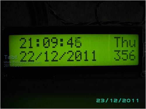

Hi Talbit,
Have you, or have you seen someone else write an elegant bit of code to convert UTC to local time, coping properly with all day/month/year/leapyear breaks properly?
I've been thinking about it lately as I have an application that requires it, but wondered if I'd be re-inventing the wheel.
AndrewB
Posts: 6640
Posted: 04:14am 18 Dec 2011
Andrew,
When doing date and time routines on the MM you have to be carefull of the maximum number of digits before loss of accuracy.
The safest way is to keep the day and the time separate.
This program converts the date into Julian Day Number and the time into seconds in the Unix tradition.
Add or subtract the time and check for any day rollover. Adjust the day to suit then convert back to readable date and time.
This program only works for time changes less than 24 hours. Doing time maths greater than that and you need to alter the rollover code.

Thanks to tassyjim's very smart code to extract the day of the week and the day of the year, I've been able to add these features to my GPS clock.
It now gives this display...
12:05:37 Tue
20/12/2011 354
and the Latitude and Longitude when you press the button.
I'll test it for a few days then post the code.
Thank you Tassyjim !!!

Here you go, just in time for Christmas !!!
The new code gives UTC Time, Date, Position, Day of Year and Day of Week. Also a couple of happy snaps to show the three readouts.
Thanks to Geoff Graham and Tassyjim.

260 PIN(18)=0 ' Switch off PPS LED
270 LCD_line1$ = " GPS Searching "
280 LCD_line2$ = " Please Wait "
290 GOSUB 12000 ' Send message to LCD

Talbit
Talbit
Joined: 07/06/2011
Posts: 210
Posted: 09:51pm 22 Dec 2011

I'm back on deck after doing other things. Here is my GPS clock with a "No Line Numbers" routine.
Nothing has changed with the hardware but I did notice it works faster.
