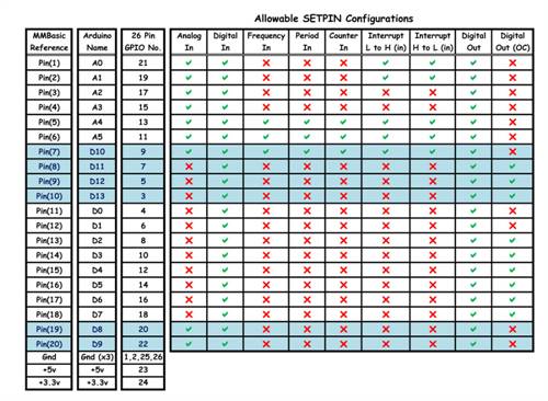

Posts: 2984
Posted: 09:19am 17 Dec 2011
  herbnz said   Hi
Trying to set up a counting routine but confused with pin numbers
PIN(4)→ ARDUINO.A3 GPIO.15 AI, DI, , , , , , DO,
PIN(5)→ ARDUINO.A4 GPIO.13 AI, DI, FI, PI, CI, IP, IN, DO,
PIN(6)→ ARDUINO.A5 GPIO.11 AI, DI, FI, PI, CI, IP, IN, DO,
PIN(7)→ ARDUINO.D10 GPIO.9 AI, DI, FI, PI, CI, IP, IN, DO,
PIN(8)→ ARDUINO.D11 GPIO.7 , DI, , , , , , DO, OC
Hi Herb, (My Fathers Name was Herb(ert).
I have just done a table for Tsvetan to consider putting in the next manual, it may make that area a bit clearer, (It may not display well on the forum but if you PM me I can email it to you (full size about 1Meg)
Let me know what you think.

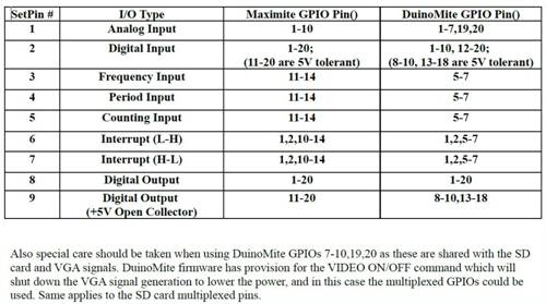

DuinoMiteMegaAn
Joined: 17/11/2011
Posts: 231
Posted: 10:56am 17 Dec 2011
I went several steps further by including all the 5 volt tolerant pins, the explicit name descriptions/functions and whether the pins are shared or not with the other I/O connectors.
2011-12-17_205613_DuinoMiteMega_Input_Output_R3.pdf
Keith @
Joined: 19/06/2011
Posts: 167
Posted: 11:42am 17 Dec 2011
Hey Guys I 'm still confused.
From the posts by Mick and DuinoMiteMegaAn I assume that I shouldn't have made a comparison and we all need to tiptoe quietly around the topic.
I've just looked at Don's website and Geoff's website and it looks like we have a conflict like that between VCR and Beta.
Keith
ps DuinoMiteMegaAn landscape orientation on your chart would be great.
The more we know, the more we know we don't know !
DuinoMiteMegaAn
Joined: 17/11/2011
Posts: 231
Posted: 11:52am 17 Dec 2011
I also released the Openoffice source code document to Don. That way you
can add/delete to it and even rotate the pdf document yourself.
BTW ... It won't fit the landscape - too much data, but it contains everything
anyone needs to know about the GPIO Pin#s. Edited by DuinoMiteMegaAn 2011-12-18

Hi Keith,
Your chart differs in some areas to Mine, I need to consult Ken and Tsvetan for clarity on these...
I garnered the data from the Manual, so there could be an error there.. I also have added a +5V tolerant column and that also differs (info from manual) from yours, I have also been asked to put the CPU Pin Numbers/names into the table and am considering this but dont wish to make it more complicated than it needs to be...
herbnz
Joined: 18/02/2007
Posts: 258
Posted: 02:03am 18 Dec 2011
If 5,6,7 are the special i/o for counting etc then the firm ware will not allow access
the firmware seems to be set to pin 11 12 13 14 15 which appears as the old Maximite code
Herb
Keith @
Joined: 19/06/2011
Posts: 167
Posted: 03:30am 18 Dec 2011
I got the info from the Olimex web site. I assume it is one created by Tsvetan.
The confusion is really being created by the MMBasic split into a number of different streams (MaxiMite, UBW32, Olimex). The only commonality being the PIC32 MCU and even then there is probably the 64 pin and 100 pin versions (I haven't checked this as the code is now being distributed in hex only).
Evolution in action ... exciting times ... exciting challenges.
Keith
