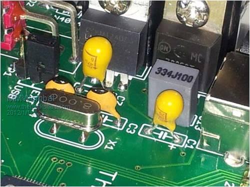

I checked all the polarized capacitors, at C1 , C7 and C5. All of them have the +ve leg in the hole marked +.
as per the picture..
The 7805 looks a little tarnished, should it be replaced...?

  MM_Wombat said   I checked all the polarized capacitors, at C1 , C7 and C5. All of them have the +ve leg in the hole marked +.
Wombat
Hmm, As I dont have an Altronics MM, I went by the schematic on Page 33 of the Silicon Chip artical which has C13 (not marked as C13) as 330uf, the same Capacitor on the schematic for MM from Geoff has it as 330nF (0.33uf)... Looking at your picture it is obvious the part supplied is the (0.33uF) nonpolarised part...
Not sure which is the correct but personally I dont think there is enough filtering if C13 is 330nF... given that many DC plug packs are not well filtered.. I reckon this is your problem... your plug pack that is used is either a poor filtered version or worse is an AC plug plack and in either case it looks like your 7805 is cooked...
Wombat
I had a look at my MM and the components look like they are all in the right positions. I suspect your trouble comes from what you mention in your previous thread (MM - DM) Computer PSU for Power several days back. The supplies being unregulated were feeding as much as 14.8 volts to the 7805. Judging by the colour of it in your photo it may now have a problem.

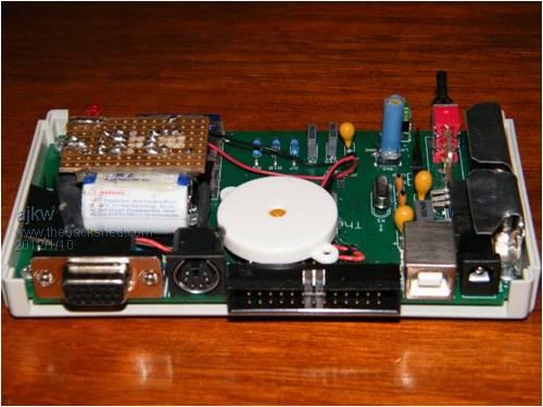

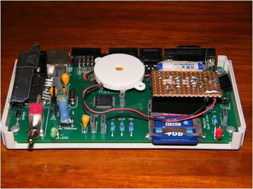

M'mmm, I didn't get heatsinks with mine so I made a couple. Mine runs off 12V and this arrangement keeps the reg's cool enough. I cut them from Aluminium sheet, note it is rather important that they do not touch each other.
Cheers,
Anthony.

Anthony
I am interested in that audio device sitting on your MM. Can you provide some details about it and that small driver board that seems to go with it.
Bob

Posted: 09:19am 11 Jan 2012
Bob,
The speaker is a transducer speaker not a piezo, I think I got it at Jaycar, see AB3440. It wasn't very loud connecting it straight to the Maximite audio out so I had to replace the resistors in-between with links. Works ok but has a very variable frequency response curve. It certainly does add sound however.
The driver board is not related to the speaker but is my RTC based on a DS1302 chip. You can also see the CR2 battery for it's backup supply. Works very well. I can supply more details if required.
