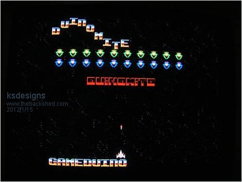

Video is not that great quality
This is a DuinoMite Mega with a GameDuino shield
Ken
Youtube Video
code is a mess but was just for testing

awesome work Ken
and just to anounce that the MOD-VGA shield which adds color to DuinoMite will be available mid February at EUR 28! with additional 512 KB of RAM memory which can be used either as video memory for resolutions up to 800x600 or just additional RAM for DuinoMite code
