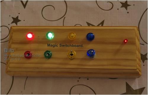

Hi all
is is a project I built using a PICAXE 18M2 so I though I would convert the code into MMbasic and try is out on my Maximite.
for those who donot know what a magic switchboar is, have a look at this on utube
www.youtube.com/watch?v=0lGP8nQLANU
this picture is of my PICAXE version.
I will follow uo with a schematic soon.

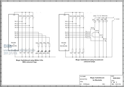

Schematic for the Magic Switchboard
Bill.b
Joined: 25/06/2011
Posts: 249
Posted: 10:01am 19 Jan 2012
sorry wrong schematic in previous post
this is the correct schematic for the Maximite
