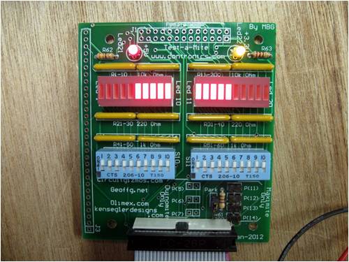

Hi All,
I have designed a tester PCB (called Test-A-Mite) that will put the MM/DM through its paces and test the following features are working correctly on our `mites.
Analog Input
Digital Input & Output
Frequency Input
Period Input
Count Input
It also has a few LED Demo routines for Fun and lets face it who doesnt like fun..
Fun LED chases as follows:
Simple LED Chase
LED Bar Graph Display
LED Cross Over
Binary Counting
All information can be found HERE including some short video clips of a DM mini connected to the Test-A-Mite doing each of the Fun LED chases
The schematic and part list is all available above so it is not too hard to make your own or PCBs are available from Dontronics for around $6ea. or $8ea including World wide Postage LETTER

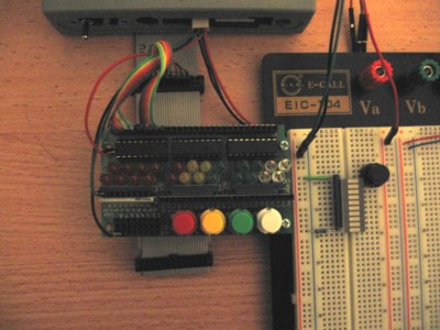

Just for a contrast to your very neat board - here's my kludge.
I did it a few months ago using one of Dontronics old SimmStick DT203 boards. One advantage is the LED's have Darlington drivers so don't load down the PIC. There's no neat IDC connection unfortunately as you can see but it is pretty flexible.
BTW - how do you make your nice photos?

Hi Greg,
I think I remember you doing that in the discussion that started me on the path of the Test-A-Mite, (I think I designed the DT203 for Don, Not sure now.... if I did it will have MBG on it some where)
The picture, believe it or not, was via my mobile phone (cheapo nokia E72), I placed the TAM on a bit of white paper, took the shot (close up and flash on) then photo shopped the cream colored paper to White and contrast enhanced..
The TAM also tests Robs CGMMSTICK1 (via the 30 pin header on the top, (as shown in the picture above)
PS, The LEDs in the TAM ahould draw 5ma each as the forward voltage of the arrays I used are 2.2v so 3.3-2.2 = 1.1 volt drop / 220 Ohm = 5ma LED current. If every switch is on will add another 3ma per pin making a total of 8ma per pin (well within the spec of 25ma max) and if every switch was on and every LED lit should be right on the limit of 160ma)

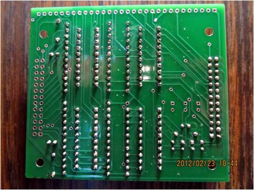

Neat project, so I sent for the board and built one.
Seems to work well except for a couple of anomalies... the Frequency, Period. and Count tests work OK but on Digital, switches 6 to 14 have no effect. On Analog switches 1 to 5 work OK but switch 6 only works if 7 is on also? Any ideas?
The "fun" tests work properly too! This is on a Maximite EV and extension cable.

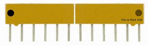

See this image.. it shows two 6 pin packs for each (12 pin) resistor array.
As can be seen the black dots (indicating Pin 1 - common-) should be at either end of the 12 pin Resistor pads.. If not that then I think maybe the resitor packs are `B' Type.. but I assume you bought them in the same batch and if half the leds are fine they must be the correct type.
Looking at my circuit I expect the packs for R45-R49 and R50-R54 are in backwards.

The board is nicely resist coated so hard to get solder slashes
The white blobs on the board are just flux splashes and the way they have photographed.
But thanks for the come back.

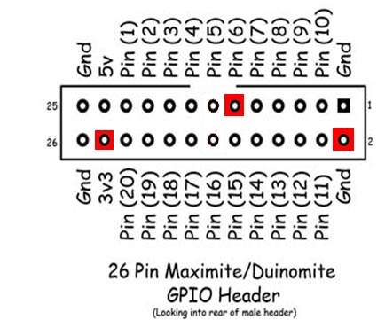

unplug the TAM from any `mite and power sources and try the following using a multimeter.
Please switch all switches to the OFF position and then switch sw-6 ON.. You should be able to measure 10k OHM between pin(6)and +3.3v and 1k OHM between Pin(6) and GND
See attached image for the relevant pins looking into the 26pin MALE header

Can you tell me what reading you get in Analog tests with switch 7-10 OFF and in both positions of Switch 6? That should give me an idea of what is wrong with the resistor divider.
Let me know what you see.
Mick,
I see 10K between 3.3 and pin6 but nothing between pin 6 and ground
Getting there

Oops, I have the two inboard pins of the two resistor sets unsoldered!
Face red...LOL Thanks for all the trouble shooting, I appreciate that
Take care, Ron
