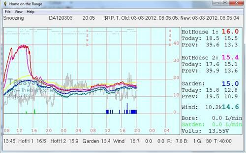

My offering is similar.
I use mainly analog sensors because that's what I was using with an old system that used a parallel port ADC module.
Temp sensors for hothouses, instrument case and ambient are LM335
I have a HIH-4030 humidity sensor from Ocean Controls (Analog output)
Argent data wind and rain.
I get a lot of spiders stopping the rain gauge from working.
I will put it into a larger cabinet with a big funnel to improve the sensitivity and have room to screen the spiders out (I hope).
Using am 8 inch funnel will bring the resolution from 0.3mm to well under 0.1mm
I have 2 water flow meters for bore pump and garden water flows.
With the 2 other counter inputs used for rain and wind speed, I have run out of counters.
Serial output is going to go to an XPORT serial to Ethernet module so I don't have to have a PC in the shed.
There is an output to switch the bore pump on/off and another one will be for watering the hothouses.
Yet another output is for load-shedding. If the backup battery gets low, the security cameras and some other equipment gets switched off.
When I go walkabout, I want the system to be able to survive long power outages.
By the time you add battery voltage monitoring and a voltage reference, I have run out of inputs.
I might have to switch over to a UBW32.
I use a laptop to interrogate the Maximite and do the main data-logging. It then emails me with the daily readings for when I am not at home.
The laptop also keeps the time correct on the Maximite which gains about 1 second a day.
The 'normal' PC draws the pretty graphs.
Today was not a good day for showing of the weather!

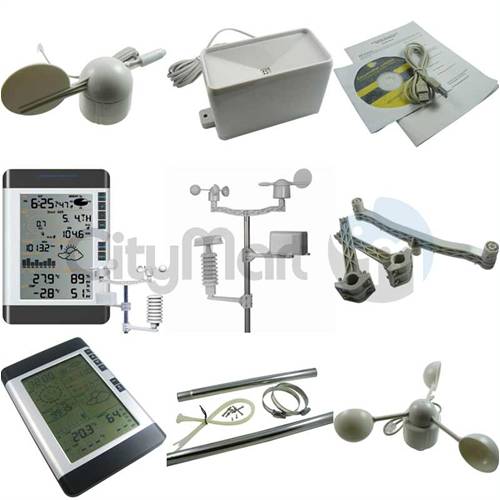

What about this one from ebay? Looks almost identical to the hardware offered by Sparkfun.
You could either hack it or use it as it is.
- Rob.

The one on ebay, XC0348 and this one WS-2080 have the same Argent Data Systems Weather Sensors. In fact, they are "almost" (the control receiver and sensors) look the same except for the WS-2080 which is $30-50 USD cheaper.
User manual - WS-2080
2012-03-07_121736_ws2080.pdf
Links:
http://www.ambientweather.com/amws2080.html
http://www.amazon.com/Ambient-Weather-WS-2080-Wireless-Stati on/dp/B003OSJ08S
The question arises, would it be cheaper to buy this "closed weather system" or to build an "open" weather station? The obvious answer is to buy one BUT since Sparkfun sells the basic weather station sensors for $69 then the only way to have a custom made "open" Maximite weather station is to find this Argent "offshore" supplier and obtain the weather sensors at a very reduced cost. Still searching ...
Edited by DuinoMiteMegaAn 2012-03-08

  aargee said   What about this one from ebay? Looks almost identical to the hardware offered by Sparkfun.
- Rob.
And all for $75 and in warehouse in Melbourne - doesn't look too shabby!

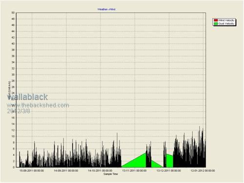

I have had this exact model now for 2 years and have had nothing but good solid performance from it. The battery in the sensor unit has been the same one from day dot and charged from it's own solar panel.
They are still available on ebay at I think under $100. I found the same problem with spiders living in the "rain gauge" which easily pulls apart. Problem is if you are anything like me you would have your weather station/annemometer at the same height as your mill.
The software package is not too shabby either with a good readouts etc. I have attached a pic of my recent wind to share with forum members.
The green shading is where it was disconnected or out of service.

My interest initially was to develop a reliable RF data network for use on the picaxe that allowed data collection and also commands to be sent to picaxe controllers for various tasks but of course there is no reason that the maximite cannot be used at both ends , providing very powerful controllers indeed.
The Weather data currently being collected by the picaxe controller is just temperature. The reason for this was that I already have a weather station (Jaycar XE0348) but I found that the temperature was not totally accurate beyond ~23 degrees C and I needed to provide a more stable temperature measurement. The picaxe controller also has a solar PV capability to provide power for the whole installation.
For anyone interested , updates will be on my website soon.

  aargee said   Wallablack,
How has the unit stood up to UV?
Is the unit showing any signs of plastic decomposition due to exposure?
This is the problem with my current old Jaycar rain gauge, apart from the fact that the electronics in it just upped and failed. No more wireless rainfall data, I think moisture got under the "black blob" IC.
- Rob.
It really has stood the test of time. I thought when I bought this one it wouldn't last but it has exceeded my expectations. As for holding up to UV - I have it up in the air and exposed to all elements and we get some really dry hot windy weather where 40 degrees is not uncommon during summer. Winter is bitterly cold but not snow weather. So, in a nutshell, it handles the elements.
Even if the elements were to damage the external plastics, all of the sensors etc are easily accessible for you to remove and house in your own manor.
