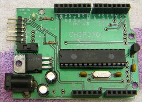

The problem with the Chipino is that the new version they sell is not the old version they advertise. And there is no schematic for the latest version.
The version they advertise is dual voltage; 3v & 5v, but that's not what you get. There is no 3-5v jumper any more, even though they advertise this as a feature, and show it in the photo of the Chipino.
You also don't get the reset switch, shown in their photos of the Chipino.
Nothing on their web site tells you that you will be paying for something different than what they advertise.

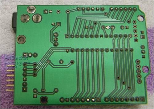

  elproducts said  The Reset switch is still on the board and that didn't change. It's connected to the MCLR pin. That never changed.[/quote]
Perhaps you would be good enough to point out the reset switch (S1) on the Chipino I bought. Here are photos of the front and back.
[IMG]uploads/ArtBecker/2012-05-17_010332_reset_o.jpg[/IMG]
[IMG]uploads/ArtBecker/2012-05-17_010403_reset_r.jpg[/IMG]

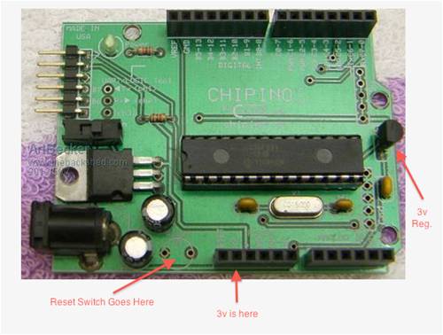

Posted: 05:52pm 16 May 2012
  ArtBecker said
I stand by my statements, and you have done nothing to disprove them.
[/quote]
See the picture below.
[/quote]
No problem. The reset switch location is pointed to in the picture below. Did you build the kit or buy it this way? It should have the switch. If you add a shield with the reset switch, it will also connect to the MCLR pin so you don't even have to populate it. The shield will do the job.

These last remarks were more for muddy0409.
I was shocked to see you had a CHIPINO. The fact you bought a CHIPINO is an endorsement enough. You obviously saw the advantage to CHIPINO and bought one yourself. And your only complaints could be be easily corrected with a simple switch soldered in place or adding a shield with reset switch installed (most of them have it).
Not having the 3v jumper is only a loss if you wanted to run a 3v PIC and you can still do that if you power from the PICkit 2. The PICkit 2 can set the Vdd to just about any Voltage level. You could also replace the 5v regulator with a 3v regulator and run a 3v part. That's also why they sell the kit version for those that want to build it their own way.

I like Chipino - thought, I would liked more if angled traces were at 45 deg.
