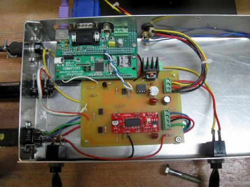

His Comments below, He has some issue with the MM and driving two steppers which is why he has used a commercial board to off load some work..
It was the maximite running a stepper motor where the timing problem shows up. One needs two precisely timed complimentary signals
and the maxi does not co-operate. That is why I went to the 'Easy Driver', no more problem as the maxi then has to only provide the step
signal, which it can do in its own time. Also the easy driver does current limiting to the stepper so I am running a 5 volt stepper on 12 volts
while the current is limited to the motor rating, not an easy task for the Maxi.

Yes, we have the Maximite multi tasking. Just to clarify, when I point to the "PWM" in the video, these are the off board components, the opto coupler, the gate driver and the power mosfet, the Maxi is doing the actual PWM (sound out, white and blue wires)
Then on start up the wire size and bobbin length are entered and the Maximite determines the number of steps needed for that size wire and how many winds before it needs to change direction. So this information, the number of steps and the direction are output to the Easy Driver which drives the stepper for the traverse.
The brass wheel contains within it a ten pulse code wheel which is used to determine when and how many step pulses are needed. Separately the maximite takes every tenth pulse and counts these to provide a total number of turns.
Some of the run up work including schematics, is in the Library, see coil winder.
This is the culmination. Hugh will enter the code in this file, thanks Hugh.
I am using a mini PS2 keyboard so it matches the small monitor size wise, here is what is under the keyboard...
Ron
